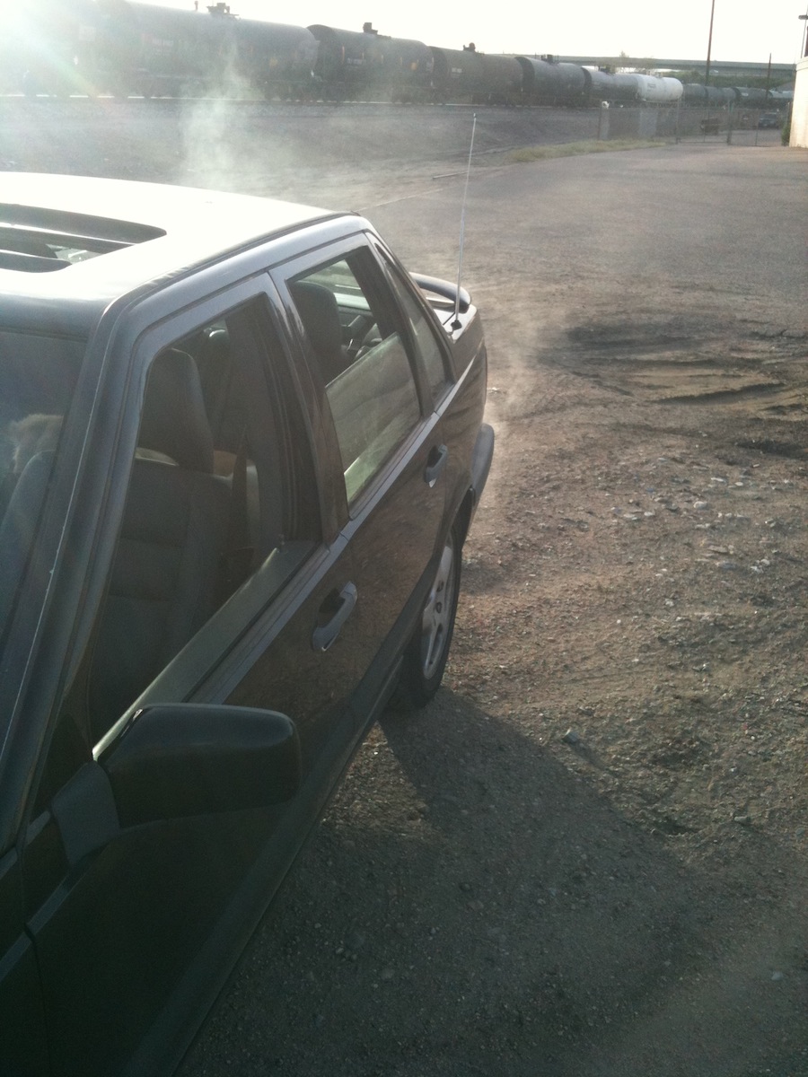

The smoke is why you want to go to a desolate industrial area — you will annoy people.
Then go for a hard drive for 5 or 10 miles. Smoke will pour out of your exhaust at first, then after a few miles will clear up to normal.
