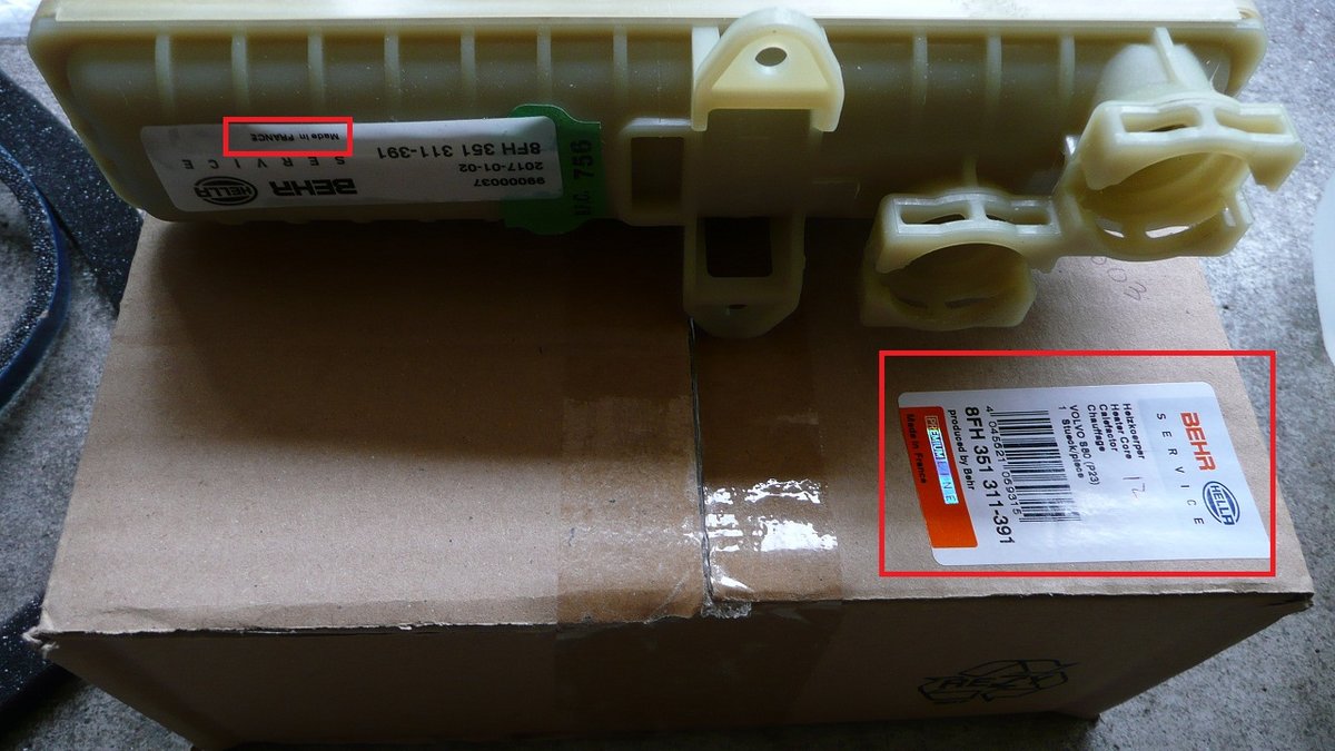

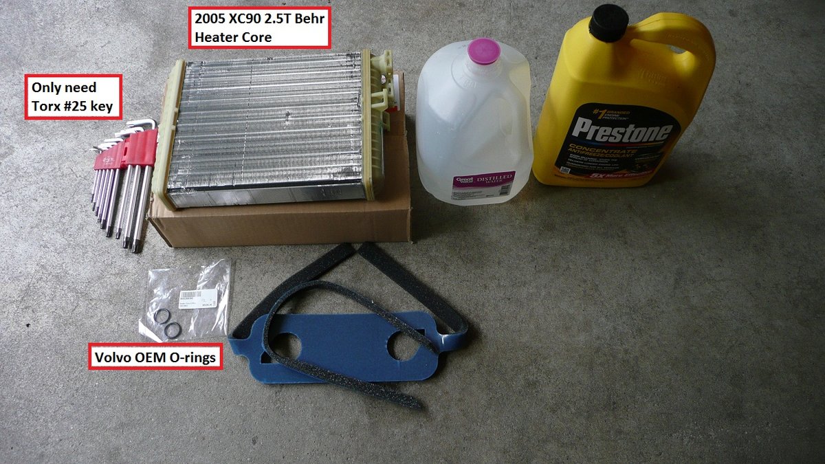

  • Time for new Heater Core. A little research showed that Nissens ($90) may leak at the crimp. A little more research showed that Behr is OEM, bought it for $95. Make sure you get the 2 new Volvo O-rings, the factory O-rings broke apart during removal.
Heater Core Replacement Parts
  • Behr Heater Core (Made in France)
  • Two (2) new Volvo O-rings
  • Plastic Bag
  • Torx #25 key
  • Coolant + Distilled water
  • Pair of channel-lock pliers

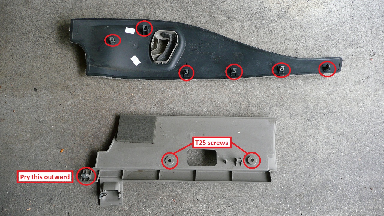

1. Remove Trim (pull it out toward you) and Under-dash trim (2 T25 screws, on the LEFT side, there is a little tab…pry it out).
