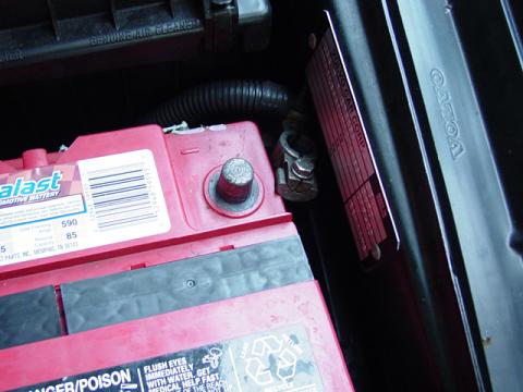

DISASSEMBLY – Disconnect the negative terminal of the battery (10mm) and position it so that it cannot accidentally make contact.
REASSEMBLY – Reconnect the negative terminal of the battery and make sure the connection is clean and tight.

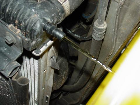

head gasket radiator drain - How To Replace The Head Gasket On A Volvo 850
DISASSEMBLY – Remove the coolant reservoir cap, open the radiator drain valve, and open the engine block drain (next picture) to drain the coolant from the engine and radiator (13mm). The radiator drain valve is located on the left side of the radiator. In this picture, the front clip that goes underneath the radiator/fan area has been removed for clarity. Also go ahead and drain the engine oil at this point.
REASSEMBLY – Refill the engine with oil. Close the radiator drain valve and fill the reservoir with distilled water (to flush with). Wait a few minutes until you can add more to the reservoir, then repeat. Keep doing this until you don’t see the level in the reservoir drop after 5 minutes. After running the car for a few minutes to circulate it, shut it off, let it cool a while, then refill with 1 gallon of pure coolant (to get the ratio right) and top it off with distilled water using the same fill procedure. Check the level (while cool, before starting) every time you use the car until the reservoir stays at the full mark (when you’re sure you have it all the way refilled). Always buy a gallon of the full strength coolant and mix it with a $1 gallon of distilled water to have two gallons of 50/50 mix for much less than what two gallons of the “premixed” coolant costs. It held close to 2 gallons.

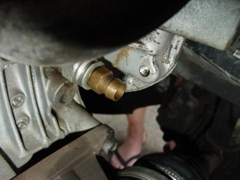

head gasket block drain - How To Replace The Head Gasket On A Volvo 850
DISASSEMBLY – Here is the engine block drain (13mm). It is located on the timing belt end of the engine, back side, down low on the block, protruding toward the rear of the car. If finding or reaching it is difficult, it can be opened later on in the repair without affecting anything. Just make sure to open this and drain the block at some point in this repair (to get out ALL of the old coolant that may have oil in it).
REASSEMBLY – Make sure the engine block drain is closed.

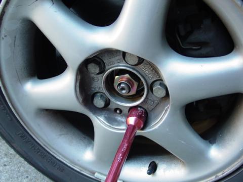

head gasket lug bolts - How To Replace The Head Gasket On A Volvo 850
DISASSEMBLY – Break loose (but don’t remove yet) all five lug bolts (maybe 1/4 turn) with a breaker bar or 4-way lug wrench (19mm).
REASSEMBLY – Torque all five lug bolts to 81 ft/lb, tightening every other one until all five are properly torqued.

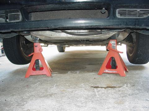

head gasket jackstands - How To Replace The Head Gasket On A Volvo 850
DISASSEMBLY – Jack the car up (with the jack on a substantial portion of the underbody) and place heavy-duty jackstands under heavy portions of the frame that will support the weight of the car, then let the car slowly down onto the jackstands. I always try to rock the car after I have the jackstands in place to make sure it is stable.
A word of caution – PROPER JACKSTAND USE ON A FIRM, LEVEL SURFACE IS IMPERATIVE. As a paramedic, I once responded to a scene where a young man was trying to remove some exhaust components from underneath a car. He had only a scissor jack holding it up and was on a dirt surface. When we got to him, he had been pinned under the car for hours and had died some time prior. Safety first.
REASSEMBLY – Jack the car up (with the jack on a substantial portion of the underbody) and carefully remove the jackstands, then let the car slowly down onto the ground/driveway.

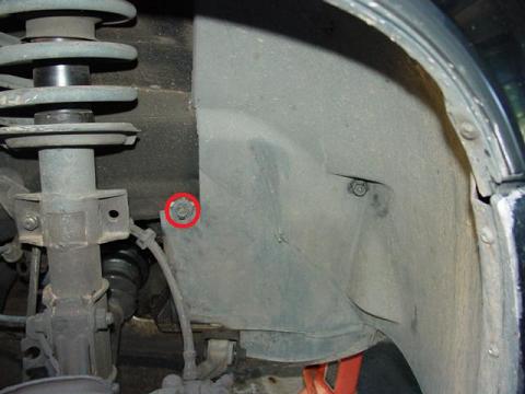

head gasket wheelwell - How To Replace The Head Gasket On A Volvo 850
DISASSEMBLY – Finish removing the five lug bolts, then remove the tire/wheel. Now remove the wheelwell apron nut circled in red, fold the apron up along the crease, and secure it out of the way (I secured it with a small spring clamp). The whole apron looked like a big job to try and remove, so this seemed the best option.
REASSEMBLY – Replace the wheelwell apron in the position it goes and secure it with the nut circled in red. Replace the tire/wheel (noting there is a pin and hole that have to be positioned right for it to fit) and hand-tighten the five lug bolts.

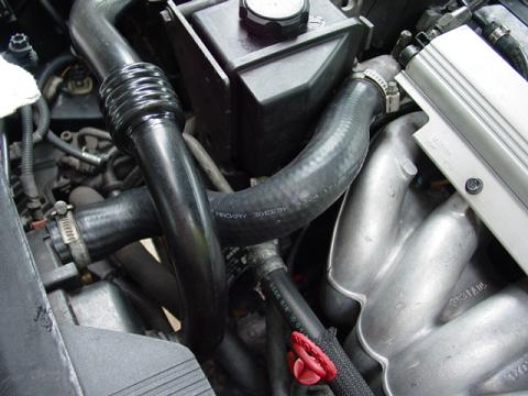

head gasket overflow hose - How To Replace The Head Gasket On A Volvo 850
DISASSEMBLY – Disconnect the coolant reservoir hose from the thermostat housing (T25).
REASSEMBLY – Reconnect the coolant reservoir hose to the thermostat housing.

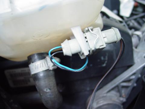

head gasket reservoir elect conn - How To Replace The Head Gasket On A Volvo 850
DISASSEMBLY – Lift the coolant reservoir out of the fenderwell bracket. Press the locking wire in and disconnect the coolant reservoir electrical connection.
REASSEMBLY – Press the locking wire in and reconnect the coolant reservoir electrical connection. Place the coolant reservoir back into the fenderwell bracket.

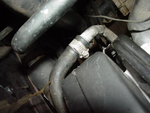

head gasket reservoir bottom hose conn - How To Replace The Head Gasket On A Volvo 850
DISASSEMBLY – Disconnect the hose on the bottom of the reservoir at the point where it connects to the water pipe at the back of the engine (Flat-head screwdriver). This is down behind the passenger side of the timing belt cover. The coolant reservoir should now be completely free from everything.
REASSEMBLY – Reconnect the hose that comes out of the bottom of the reservoir where it connects to the water pipe at the back of the engine.

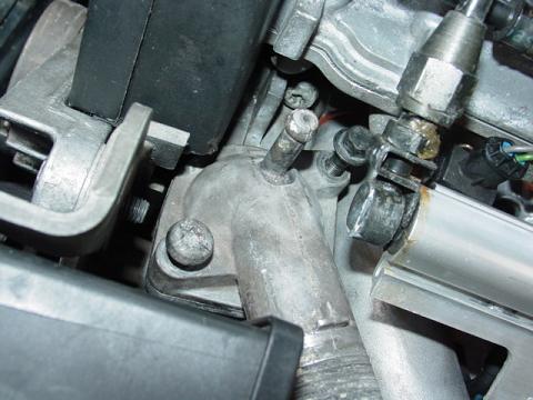

head gasket thermostat housing - How To Replace The Head Gasket On A Volvo 850
DISASSEMBLY – Disconnect the plastic tube leading from the radiator shroud to the computer box (the one with an accordion segment in it). It just snaps into place at both ends. Remove the top radiator hose from the radiator and the thermostat housing (Flat-head screwdriver). Remove the top of the thermostat housing (T40 – and a 10mm bolt on mine). Also remove the thermostat and gasket.
REASSEMBLY – Replace the thermostat and gasket (FCP Groton Part #271664 for both). Replace the thermostat housing. Replace the top radiator hose (FCP Groton Part #1335433) at the radiator and the thermostat housing. Reconnect the plastic tube leading from the radiator shroud to the computer box.

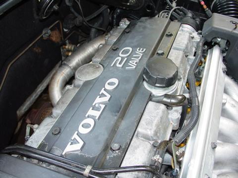

head gasket head cover - How To Replace The Head Gasket On A Volvo 850
DISASSEMBLY – Remove the six bolts (T30), then remove the cover from the top of the engine.
REASSEMBLY – Replace the cover on top of the engine and reattach it with the six bolts.

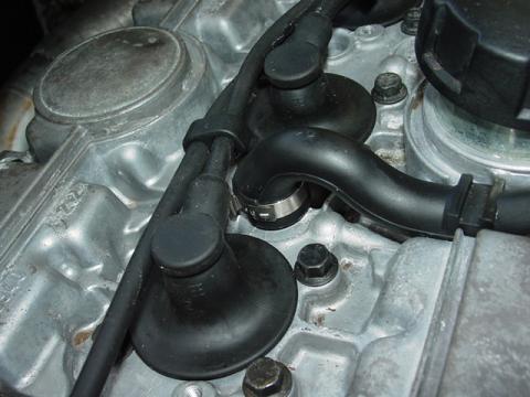

head gasket pcv top hose conn to engine - How To Replace The Head Gasket On A Volvo 850
DISASSEMBLY – Disconnect the top PCV hose from the top of the engine and leave it to the side. Mine came off with just a little rotation and pulling. This will stay where it is for now.
REASSEMBLY – Reconnect the top PCV hose to the top of the engine. Mine went back on with just a little rotation and pushing, with the original clamp still in place.

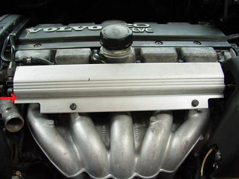

head gasket injector cover - How To Replace The Head Gasket On A Volvo 850
DISASSEMBLY – With the bottom channel as the pivot point (red arrow), tilt the fuel injector cover back toward the front of the car and remove from the channel.
REASSEMBLY – Insert the fuel injector cover back into its channel (red arrow), and tilt toward the rear of the car to secure it in place.

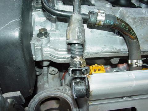

head gasket fuel line rail conn - How To Replace The Head Gasket On A Volvo 850
DISASSEMBLY – Disconnect the fuel line from the fuel rail (17mm). There are remnants of some type of sealer “skin” at the bottom threads of this connection that I missed removing before taking this picture.
REASSEMBLY – Reconnect the fuel line to the fuel rail.

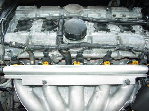

head gasket fuel rail to intake - How To Replace The Head Gasket On A Volvo 850
DISASSEMBLY – Remove the two bolts (circled in red) that secure the fuel rail onto the intake manifold (10mm). Using even pressure all along all 5 injectors, remove the fuel rail and injectors from the intake manifold. When I removed mine, all five injectors remained in the rail and came out of the holes they were in on the intake manifold. The injectors are held in the rail and the manifold by snug O-rings, with no fasteners to remove.
REASSEMBLY – Using even pressure all along all 5 injectors, reinstall the fuel rail and injectors to the intake manifold. Make sure that each injector nestles into the corresponding hole for it on the intake manifold, push in until it seats, and take care not to damage the ends of the injectors. Reinstall the two bolts (circled in red) that secure the fuel rail onto the intake manifold and torque them to 88 in/lb.

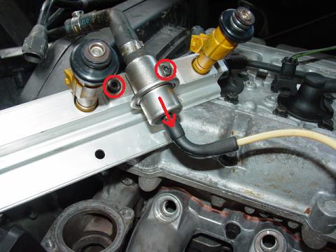

head gasket pressure regulator vac line - How To Replace The Head Gasket On A Volvo 850
DISASSEMBLY – Disconnect the vacuum line from the fuel pressure regulator (red arrow). Then remove the regulator from the fuel rail (T25 – red circles). The fuel rail should now be completely free. Secure the fuel lines out of the way.
REASSEMBLY – Reattach the fuel pressure regulator to the fuel rail and reconnect the vacuum line to the fuel pressure regulator (red arrow). Make sure and reattach these in such a way that they will be positioned right when you twist the rail back over for installation into the intake manifold.

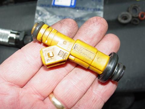

head gasket injector - How To Replace The Head Gasket On A Volvo 850
DISASSEMBLY – Carefully remove all 5 injectors from the rail, taking care not to damage them.
REASSEMBLY – Remove old fuel injector O-rings/spacers (taking care not to damage the injectors) and install both new O-rings (top and bottom – same size – 2 come in set, FCP Groton Part #30731375 need 5) and the spacer (bottom – larger than O-rings, FCP Groton Part #6842408 need 5). I also bought 5 of what was called an “upper spacer” (FCPGroton part #3528216) but could not find any place it would fit or any old part for it to replace, so it is in my “parts I might need later” collection. Insert fuel injectors into the fuel rail with a twist and a push until they bottom out in the fuel rail. You want the electrical connections facing the same side of the fuel rail as the fuel inlet nipple is. I applied a very light film of moly grease to the O-rings to aid in putting them on the injector and to lubricate them for insertion into the fuel rail and the intake manifold. I also applied a very light film to the ports of the fuel rail before inserting the injectors.

REASSEMBLY – Underneath the throttle body, reconnect the hard line (red circle) that runs from back of the EGR valve to the exhaust manifold. Reattach the EGR temperature sensor (yellow circle) that connects to the side of the EGR valve (twist the wires counter-clockwise 6 or 7 turns to account for the turns in the wires once tightened).
DISASSEMBLY – Also disconnect the hard line at the exhaust manifold on the rear of the engine (Crescent wrench on both ends, as it was bigger than 20mm – the largest combination wrench I have).
REASSEMBLY – Reconnect the hard line at the exhaust manifold on the rear of the engine.
