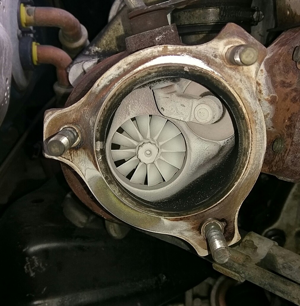

If you find it relatively clean in there, then the guides would be suspect, but not a sure thing. To dig deeper if needed, I would drop the exhaust down-pipe before hanging any one criminal. 3 nuts and you’ll be able to manipulate the shaft with your fingers. Move it side to side and in and out. You should have some side to side and next to nothing for in/out.
This would be my suspect… oil on the back side of the compressor wheel, being atomized in the intake track after a hard accel (high oil pressure). A slightly thicker oil next change can help tell you if it’s simple wear (bearings or guides) or a bigger failure pending but it’s only a mask for the inevitable failure.
