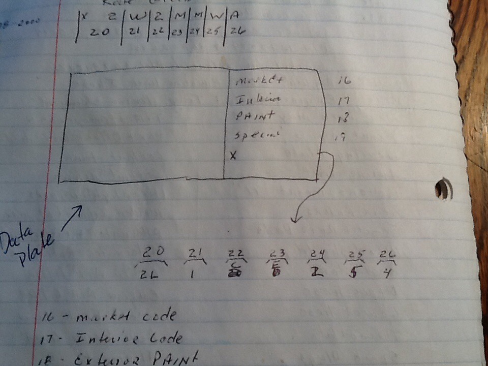

Data plate right side in engine bay inner fender…
Also look at the rack itself (duh):
Totally worth it to just take a look at the boots, the TRW racks say “TRW” on the rubber boot, if you see that then you have solved it for your car. The TRW racks are much more common, too.
Plate Decode -
Data plate steering rack numbers decode: The last number on the right side of the data plate at the bottom will be a 4 or a 5. That will tell you what rack you have.

So… about this data plate…
It’s here. (But on the inside. Pop the hood.)
98v70dad » It is difficult to read my data plate so I just did a rubbing with a piece of paper and a lead pencil. I clearly have a 7 digit number. Its either 4F2PEV5 or 4F2PEVS. I rubbed it twice and the last digit is almost certainly an S as in SAM. What I understand is seven digits means TRW and the value of the last digit is irrelevant so it doesn’t matter that it might be a 5.
