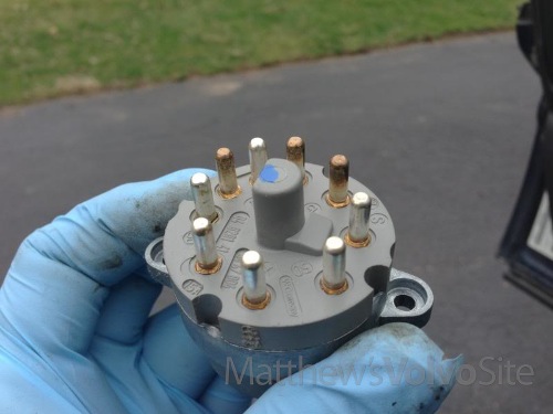

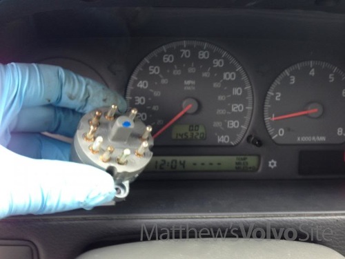

The electrical switch can wear out too. You could encounter a no start condition or electrical gremlins. We’ve seen warning lights activate, power windows not working, and many other problems caused by a faulty ignition switch. If you have low voltage to fuses or weird electrical problems, check the power out of the switch. It should match battery voltage. If it doesn’t, there may be resistance inside the switch, dropping the voltage and causing a range of issues.

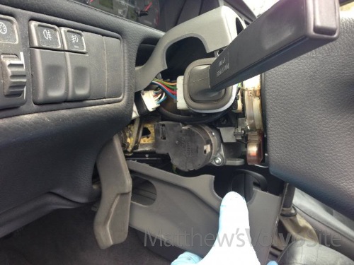

The problems described above may be the result of a mechanical lock or an electronic switch. The mechanical lock cylinder is unlocked with the key allowing a cylinder to rotate in turn rotating an electronic switch on the opposite end. To replace the electronic ignition switch, you do not have to remove the steering wheel. You can remove the steering wheel trim cover, then access the electric switch.

MVS Forums moderator abscate explains how to do this very quick fix, and lists the telltale signs that it’s due: “Typical symptoms – erratic ABS, CEL STS or other lights – often coming on after a bump in the road. May or may not be controlled by thumping steering column.
Elapsed time from hood open to closed, 10 minutes.”

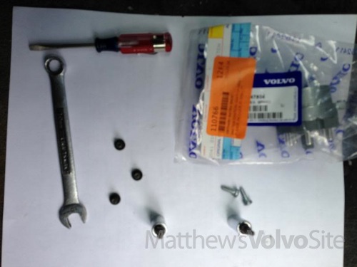

Tools needed
  • Small Screwdriver, flat – easing open plastic case around steering wheel
  • 11 mm wrench for negative battery terminal
  • Torx 20 bit
  • Torx 25 bit
  • 4 inch extender
  • Replacement switch
1999 V70 T5 Ignition Switch replacement with Pictures
