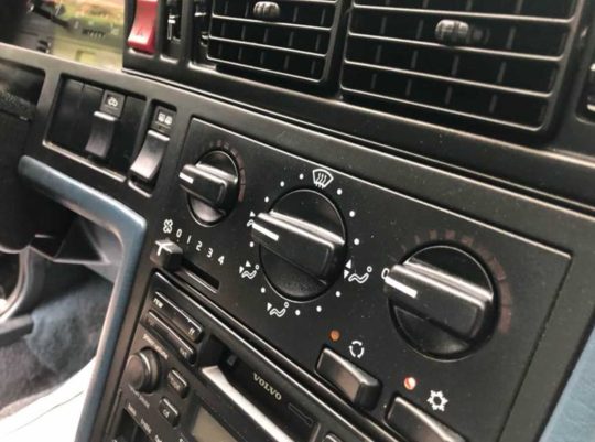

I have a dial on my climate control which i turn to the desired air flow. Are you telling me that for each location there is a cable that moves the Volvo damper or is there a motor that moves it? I am confused if there is a cable why does my defrost and my cabin vents work. I can switch back and forth from defrost to vents without a problem but not to the floor.
