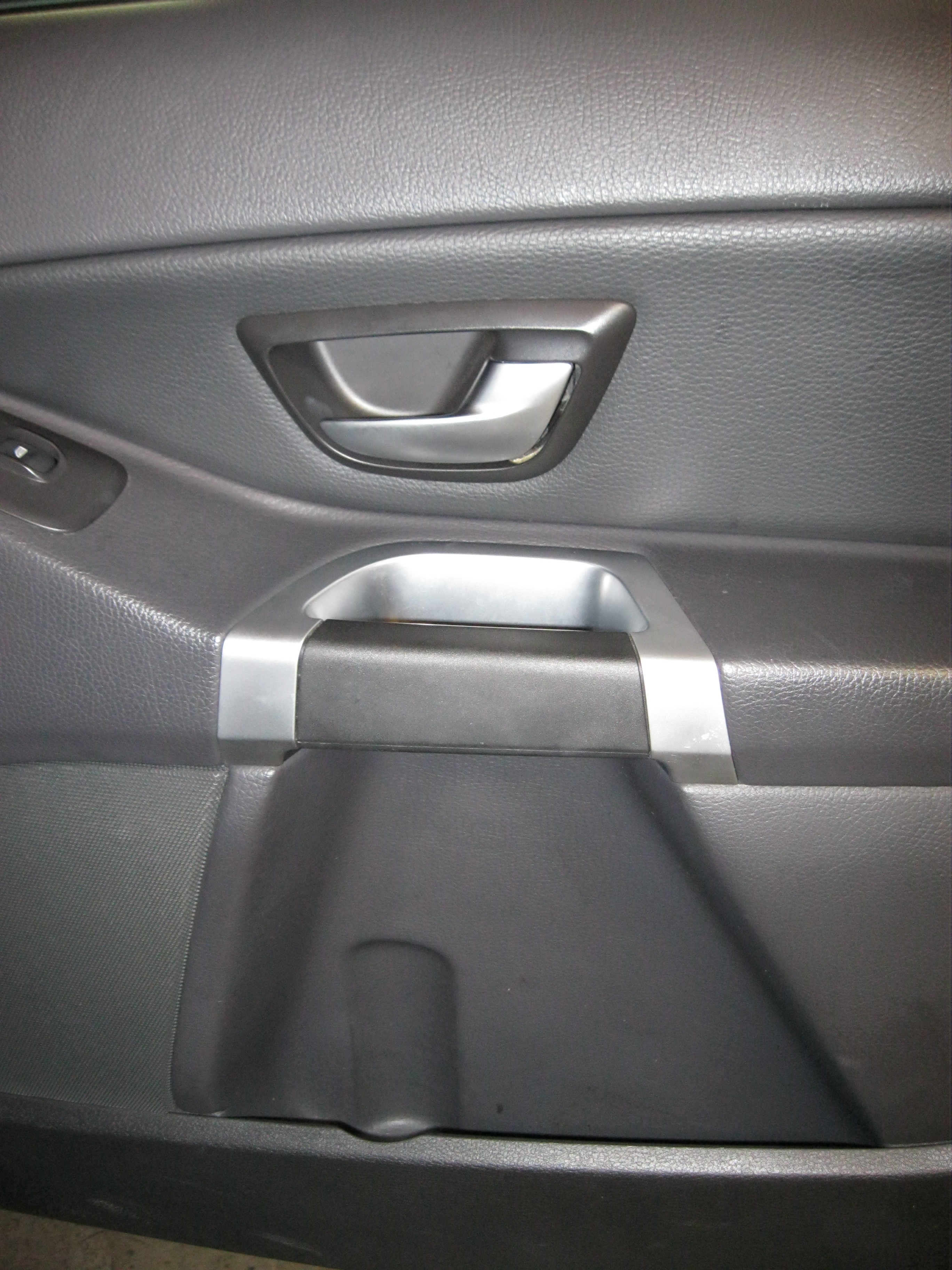

Like anything else Volvo, there are chassis breaks and model years (and interior codes) to contend with. The black part is on the base, and PN looks like this (post 2007)-
Base
Handle, left 1.00 39896654 CH -519165, Interior code: CH7X., Interior code: C00X, C70X, C90X., Interior code: CF0L, CF00, CF0D., Interior code: CB0B.
Handle, left 1.00 39803539 CH 519166-, Interior code: CH7X., Interior code: C00X, C70X, C90X., Interior code: CBOE., Interior code: CF0L, CF00, CF0D., Interior code: CBQX., Interior code: CM00.
Handle, right 1.00 39803542 Interior code: CH7X., Interior code: C00X, C70X, C90X., Interior code: CBOE., Interior code: CF0L, CF00, CF0D., Interior code: CBQX., Interior code: CBSB.
Handle, left 1.00 39865867 Interior code: CU0P., Interior code: CU00., Interior code: CBSB.
Handle, right 1.00 39865869 Interior code: CU0P., Interior code: CU00., Interior code: CB0B.
Handle, left 1.00 39803541 Interior code: CX1X, CH2X.
Handle, left 1.00 39865868 CH 495001-, Interior code: CU10., Interior code: CUSU.
Handle, right 1.00 39803544 Interior code: CX1X, CH2X.
Handle, right 1.00 39865870 CH 495001-, Interior code: CUSU.
Handle, left 1.00 39803540 Interior code: CX5X.
Handle, right 1.00 39803543 Interior code: CX5X.
Top
Handle, chrome-plated, left 1.00 30716085
Handle, chrome-plated, right 1.00 30716086
Pre-2007

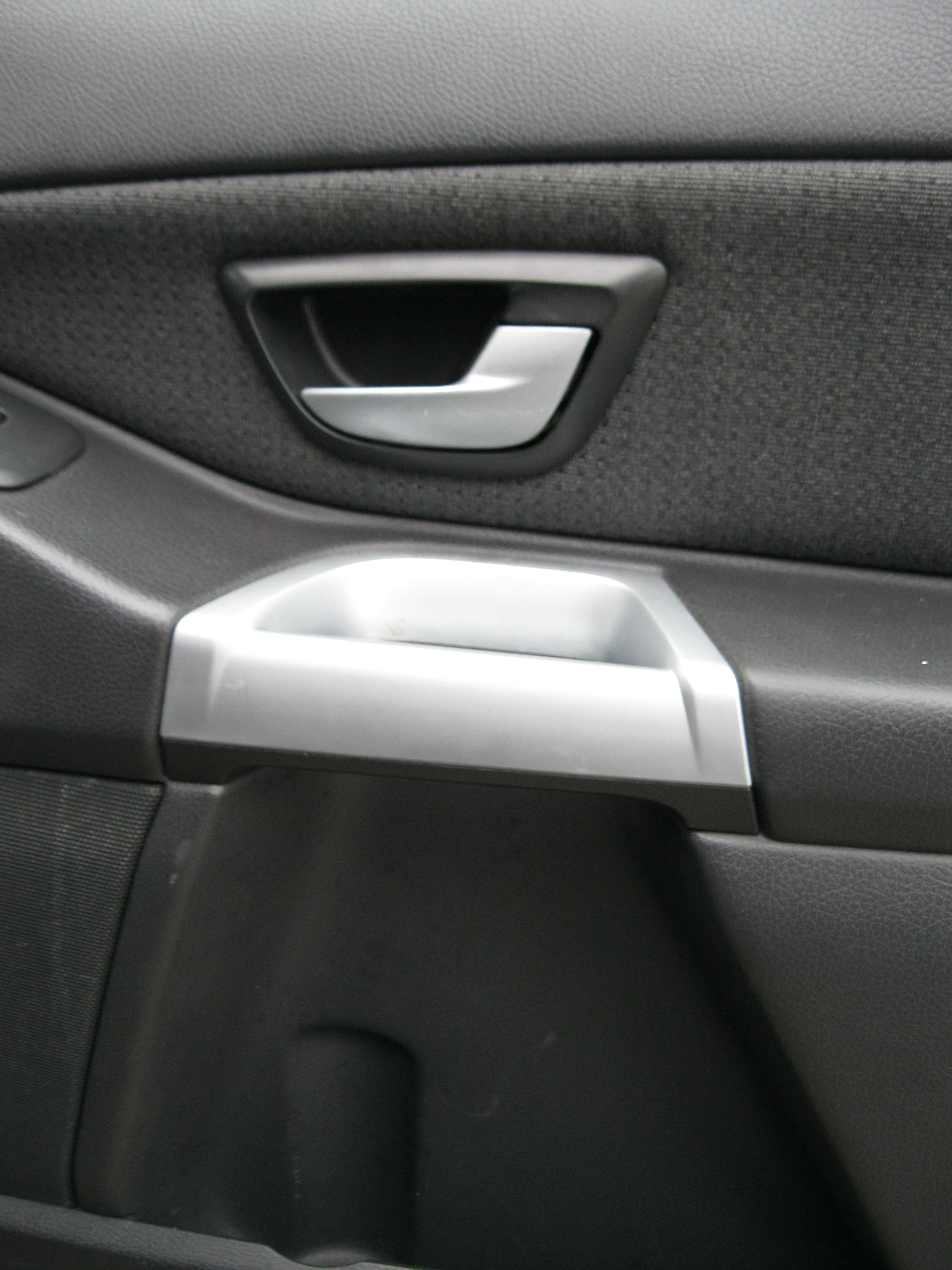

If anyone is interested in the pre-2007 PNs (solid, no band in the center)-
Base
Handle, gray, left 1.00 39974455 Interior code: VOR2., Interior code: CH0X, CH8V, EXC, CH0L., Interior code: CX7X.
Handle, oak, left 1.00 39974456 Interior code: CF3L, CF90., Interior code: VOR3., Interior code: CX8X, CH0L EXC CH8V.
Handle, gray, right 1.00 39974457 Interior code: VOR2., Interior code: CH0X, CH8V, EXC, CH0L., Interior code: CX7X.
Handle, oak, right 1.00 39974458 Interior code: CF3L, CF90., Interior code: VOR3., Interior code: CX8X, CH0L EXC CH8V.
Top
Handle, aluminum, left 1.00 30674710
Handle, aluminum, right 1.00 30674711
Interior code is on the metal plaque under the hood on the fender (driver side?) for early model cars, and it’s on the bottom of the black label behind the passenger side B-pillar for latter model cars. Chassis (CH) number is last 6 of VIN. The door panel PN does not change over the years so the handle “should” be a direct swap if both base and top are sourced. The door itself does note a couple chassis breaks for PNs but the breaks don’t align with any of the door handles which suggests there is probably no mounting change but you’ll only know when you try and bolt it on.
Photos of my 2005 (C070) and 2008 (CBSB)-
