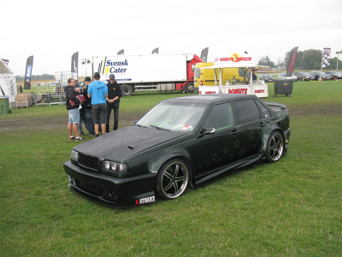

Volvo 850 from August 2013 event.
Photo credit via Wikimedia Commons to nakhon100 / CC BY (https://creativecommons.org/licenses/by/2.0).
