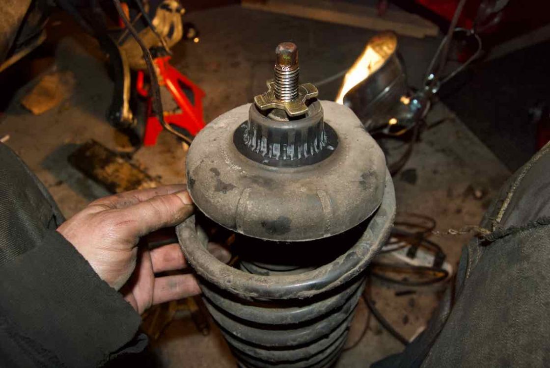

3. Springs are fine, unless you’re looking for a performance or appearance upgrade
4. No springs in rear, just shocks and upper shock mounts

You will also need spring seats in the front. Check the ball joints, control arm bushings, tie rod ends and sway bar end links while you’re in there.
