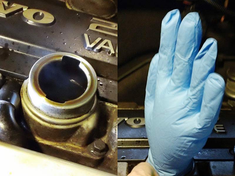

Symptom: leaking Rear Main Seal but…….at the end there was no clogging of my PCV at all, so I have the RMS replaced by my indy because it is such a big job.
Since my car was driven on mostly highway (60%) and city driving (40%) is usually more than 10 miles, and also since I changed my oil twice a year (every 5K), there is virtually no clogging of the PCV at all. All the orifices have some deposit but the clog is about 5%. So I ended up with a brand new PCV system and a write-up for you guys!

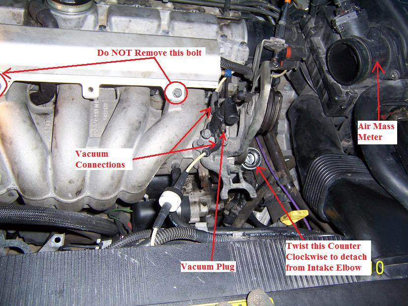

– Remove electrical connections to Throttle and Idle Valve

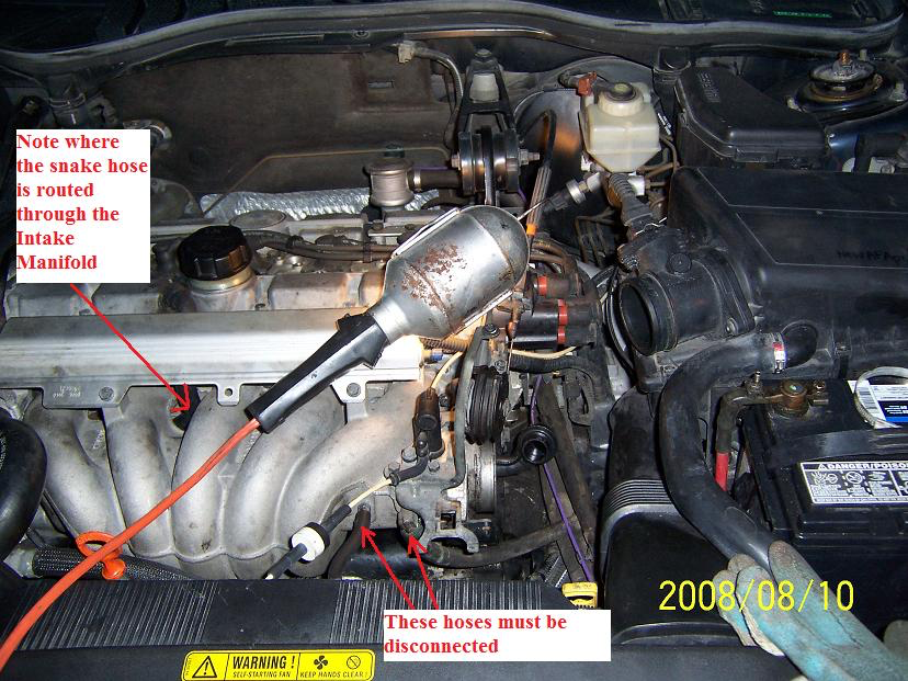

– Remove these 2 hoses (my vacuum hose is brittle so I replaced it)
– The PCV connection to elbow: turn it Counter-Clockwise (when viewed end on, similar to opening a bottle cap) a bit, it will come off the plastic Elbow.
– Remove large clamps holding the Elbow and remove the Elbow from the Air Mass Meter and Throttle Intake. The manifold is now attached only by: throttle cable, wiring to fuel injectors.
– When removing vacuum connections, watch for the Rubber Vacuum Plugs, they can be knocked off and difficult to find.

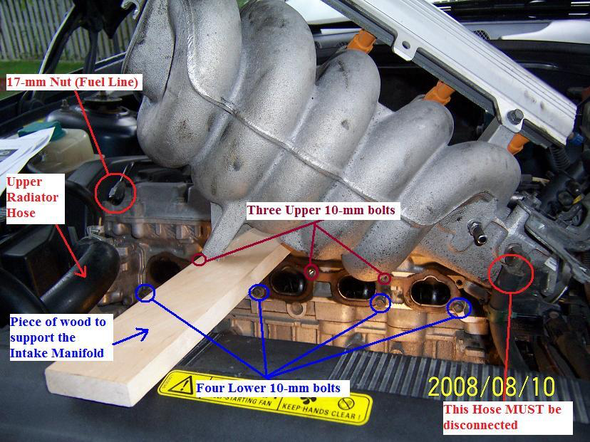

– To disconnect Fuel line (which is flared fitting if you are familiar with home plumbing system), 17-mm wrench of the large nut and 14-mm (or 9/16″) wrench on the fuel rail.
– Slightly move the fuel line a bit to ease removal of the Intake Manifold.
– The Intake Manifold has 3 Upper bolts and 4 Lower bolts. Remove the 3 Upper bolts using 10-mm socket with swivel and telescoping magnet. Do NOT remove the 4 Lower Bolts, loosen them only (Do NOT remove them).
– Underneath the Intake Manifold, there are two (2) 12-mm bolts holding the Manifold and Engine Oil Dipstick.
– I use a piece of wood as a “bridge” to rest the Intake Manifold to avoid straining the driver side connections (throttle cable, wiring to fuel injectors etc.)
– The Oil separator has 2 bolts. The short rubber hose to the engine block uses 2 clamps (torx).
– As mentioned in the other write-up. Make a note of the hose connections so you do NOT get mixed up. Also attach the hoses and clamps on the Oil separator before installing the Oil separator.

– Install new gasket. I apply a bit of grease to help hold the gasket in place during installation. NOTE: Now remove all 4 Lower Bolts, then loosely install them with ONLY 3 turns to allow room for the Intake Manifold to go in. Watch the passenger’s side of the Intake Manifold, it can hit the Upper Radiator Hose near the thermostat!
– Do NOT forget to re-attach the small vacuum hose attachment on the pass side of the Intake Manifold. Then snake the Rubber Hose through the Manifold between the 3rd and 4th Intake Space. Re-install the Intake Manifold taking care NOT to damage the gasket. Tighten all 7 bolts. Do NOT forget the 2 bolts underneath the Manifold.
