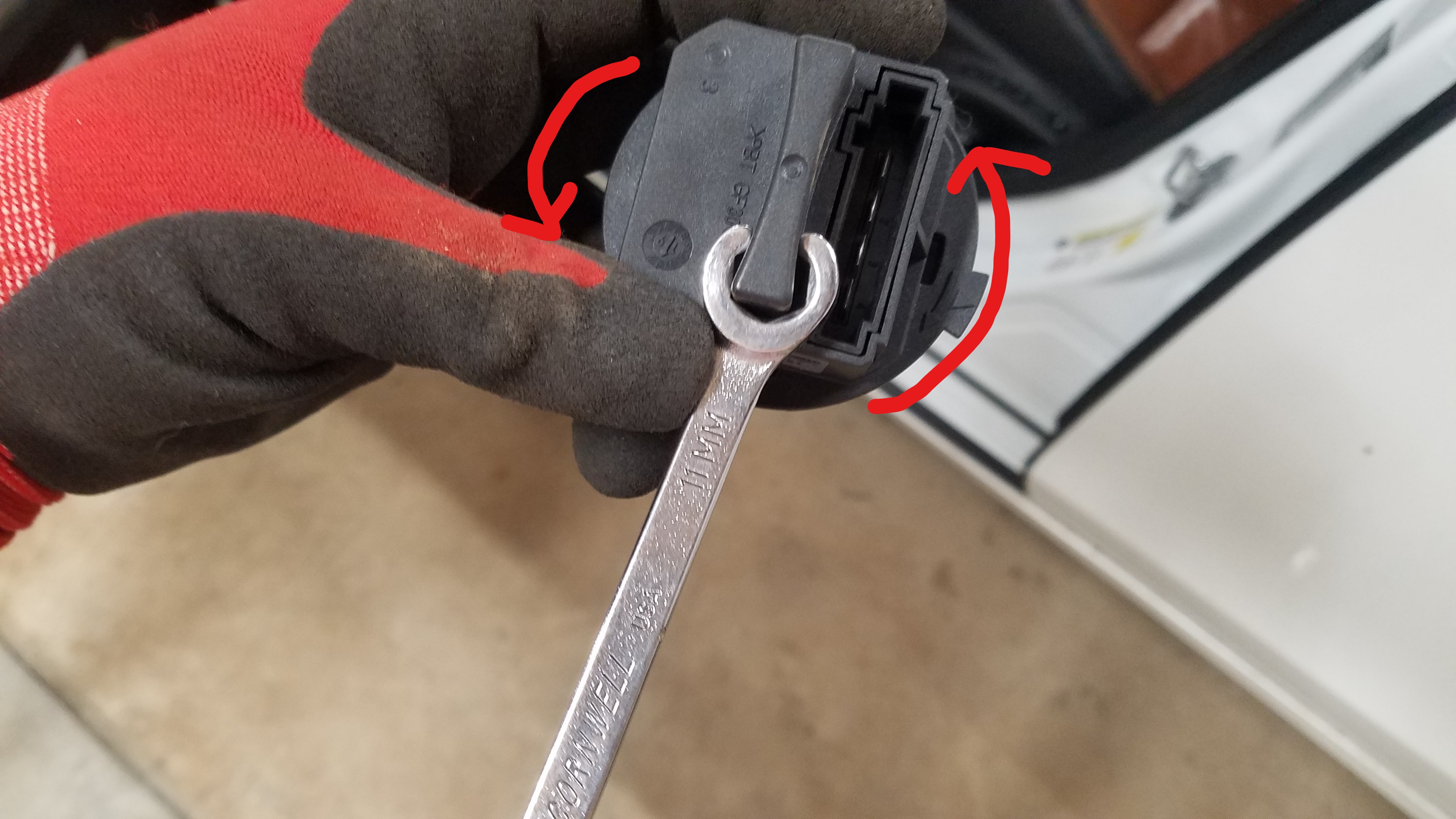

  • -~~11mm wrench- longer is better, and the type that cannot slip directly off works best- see pics

Now it is time to remove the resistor. Take note of the correct orientation before you remove it. This took me 2 hours to figure out- even if you have small hands there is zero clearance to twist the component with any force because you cannot close your hand over it. You could try removing the steel gas pedal support that is in the way but I think it connects further up in the dash behind the cluster. This is where the wrench comes in… I was only able to get it to work with one that has curled lips to keep it from slipping off. standard wrenches just slipped off and hit me in the face. Not sure what this type of wrench is called?
The orientation in car roughly matches the picture below as viewed from the driver’s side footwell. Turn the resistor counter clockwise about 1/6 of a turn and it will pop loose. From there you can wiggle it free and wiggle the new one into place. Installation is the reverse of removal :)
