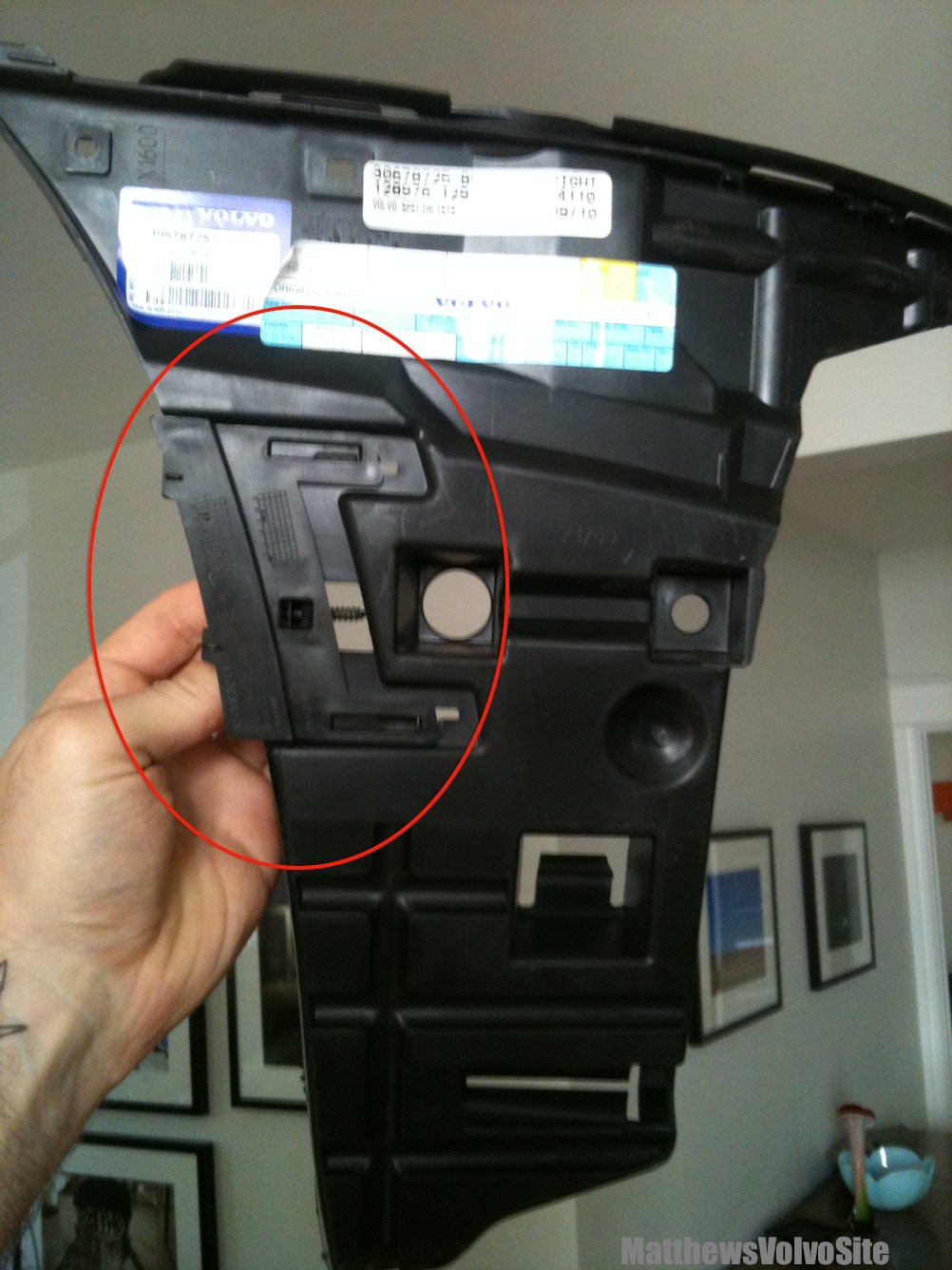

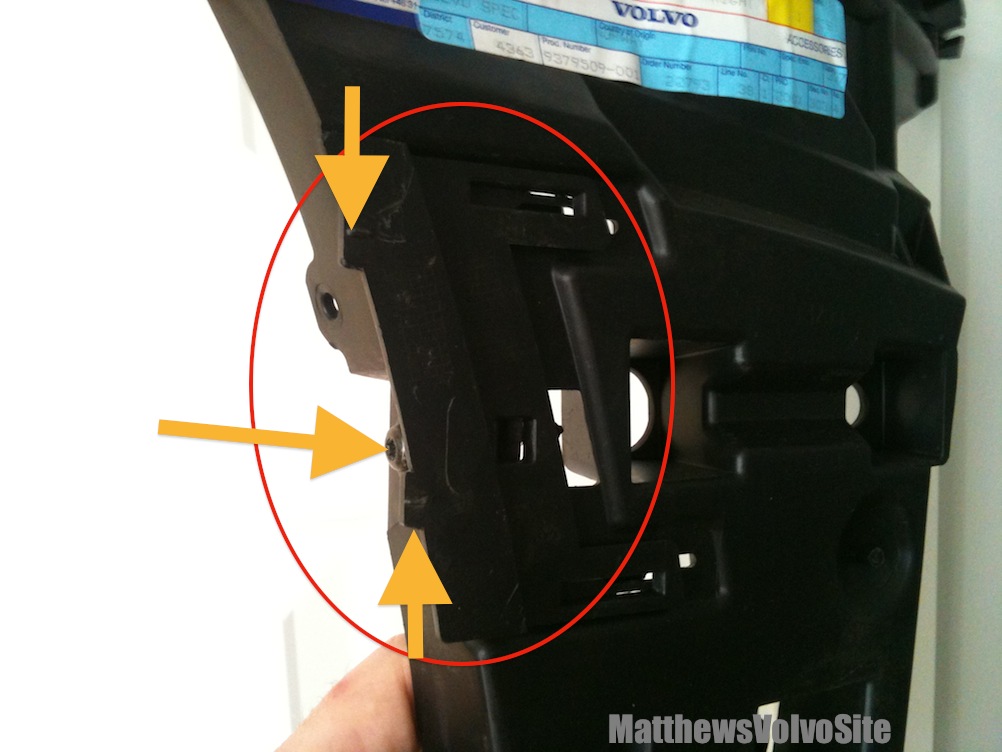

  1. Use a torx to dial the screw (and the circled plastic bit) toward the front of the car.
  2. Using your hands, push the bumper back up, slotting the tabs and lip under the headlight where they go.
  3. Pull the bumper back so that the tabs of the piece circled in the photos “catches” the catch in the bumper. The tabs (arrowed) will find their place on the bumper.
  4. Use the torx to dial the screw so that the circled plastic bit moves toward the rear of the car, snugging up the bumper.
bumper-bracket-30678725-2.jpgThis is the part you’ll either adjust, or have to buy (then adjust) if it’s broken. Inspect yours first. Volvo part #30678725.
