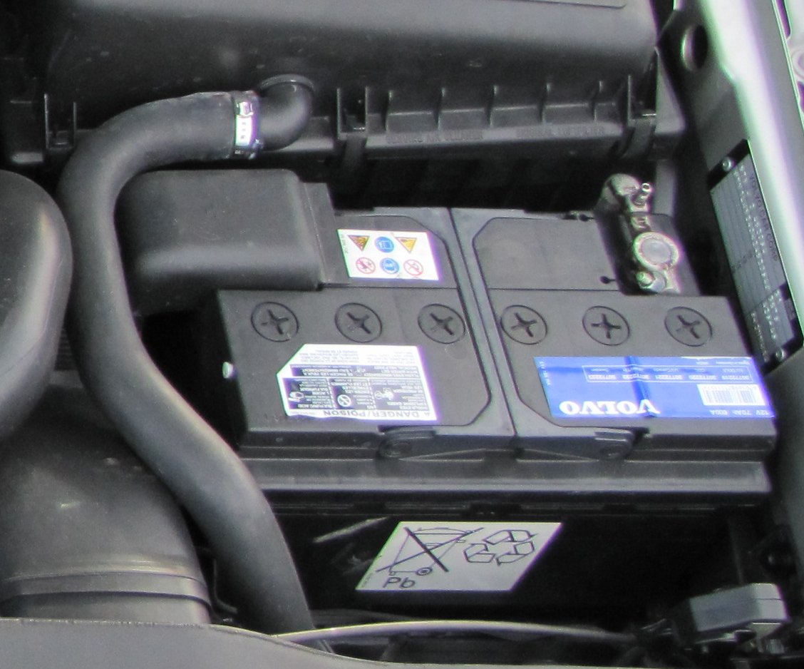

Annnd the rest… like I think I need a new battery!
How to know if your Volvo needs a new battery, how to test the battery, how to get the right fit, and where to buy it.
