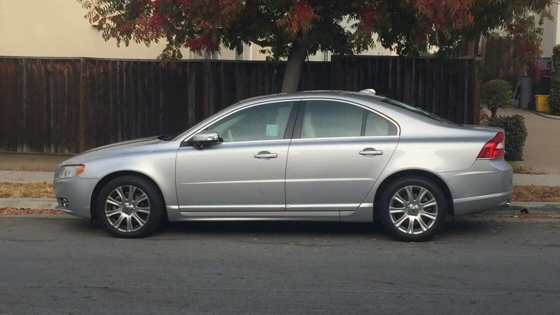

A little over two years ago, MVS Contributor Paul decided to challenge himself. Could he buy and use a 2nd-gen S80 for 10 years or 100k miles for $10k or less, including the cost of the car?
Here is the challenge
  1. Buy a S80 sedan
  2. Fix everything that ails it, including preventative maintenance for any common failures
  3. Drive it for 10 years or 100,000 miles
  4. Keep track of purchase price and all maintenance (cost of parts only, labor is free)
  5. Do it for $10,000 or less
