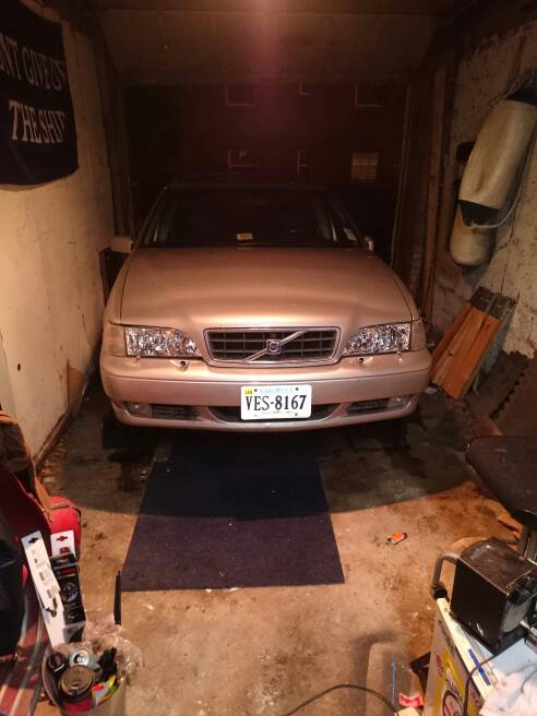

I just put in Depo jewel headlights (for 2003-2004 C70) in my 1998 V70 last night. The difference is dramatic. It is a simple swap – 6 bolts – and they are in. I am waiting for the matching corner lamps to be delivered, but I think they look great. I bought them on Amazon for about $240 (corners were another $150).
The old headlights had the swapped lenses and they looked okay, but not nearly as bright as the jewels.
I considered the projectors, but I don’t really care for how they look. I think they look good on some cars, but overdone on others. That said, the lights I just put on are much more flashy than the old ones, but I like the look. Without the matching corners it looks kind of half done or I would have skipped that part. My old lights had new lenses and they weren’t bad, but they don’t put out as much light as the jewels.
