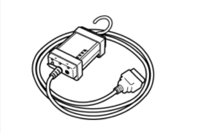

  • DiCE–Diagnostic Communication Equipment, is a tool that is used together with VIDA all-in-one to communicate with the vehicle. Communication makes diagnosing and troubleshooting the vehicle possible, as well as downloading software.
  • DiCE is equipped with four status LEDs that indicate the status of the software, the USB communication and the interface to the car.
  • It has integrated module, this allows more comfortable work, no need of cable connection to PC now! DICE is connected to the vehicle`s OBD diagnostic socket.
  • This is the latest Volvo tool to replace the well-known VCT2000 device.
