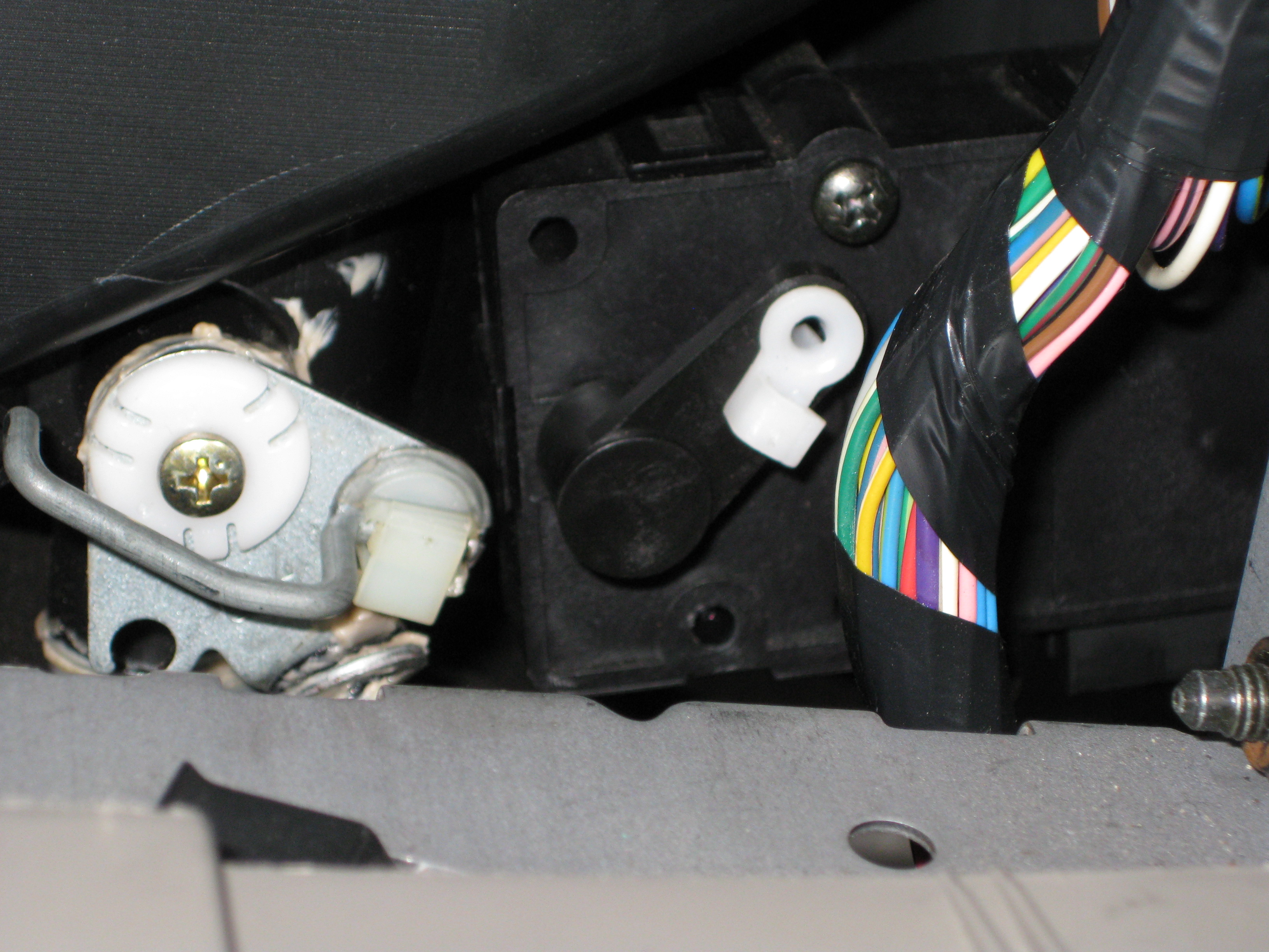

Can I do a Volvo damper motor repair? My damper motor stopped responding to changes in the temperature dial, leaving me with a car that was either 100% on full heat or 100% on cold. Eventually, I disconnected the damper motor arm so that I could just change the damper myself manually. This was a pain, though, since I’d have to remove the radio to access the damper arm.

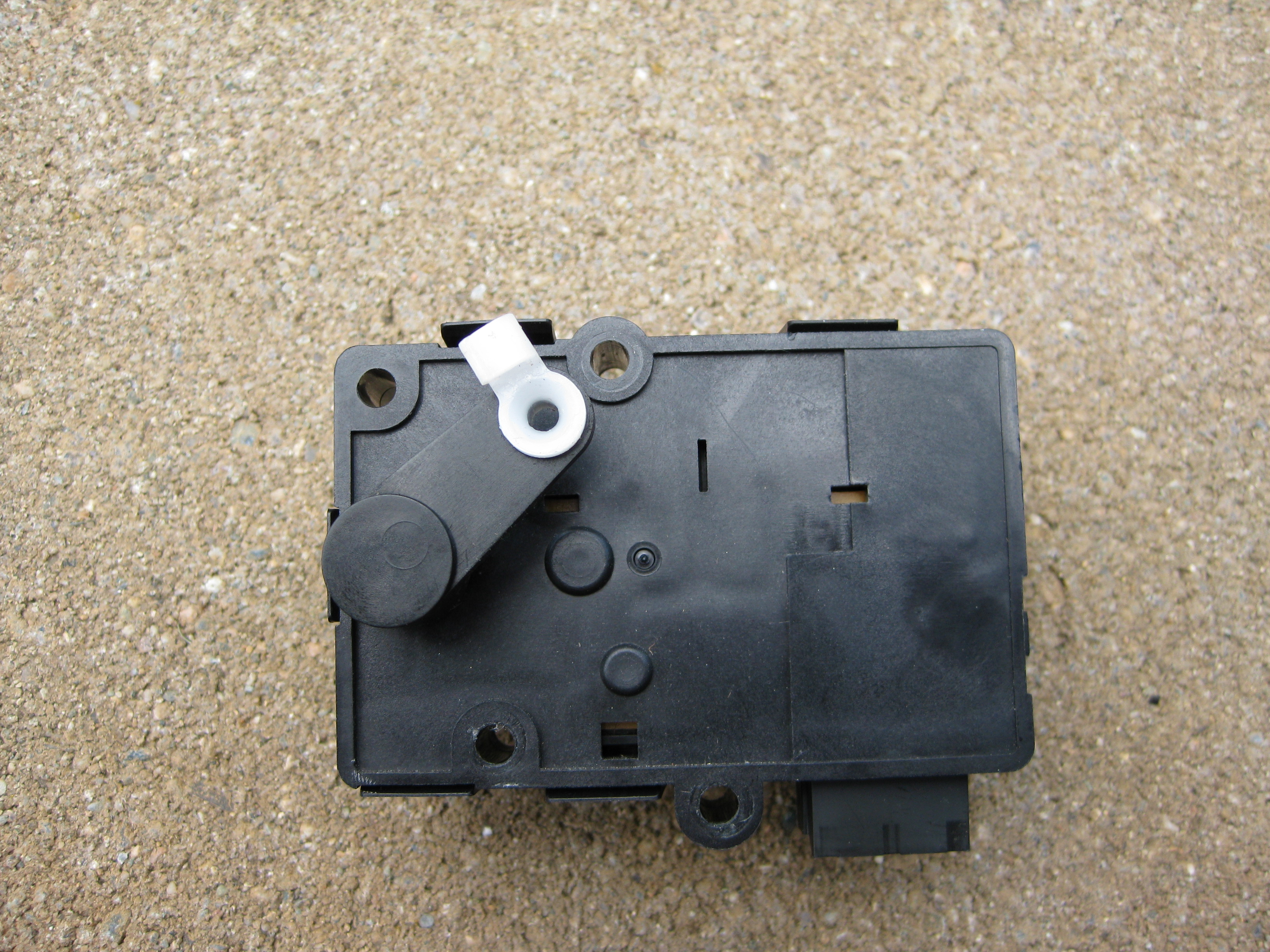

Here is a picture of the damper motor with the arm removed. This is visible once you remove the radio.

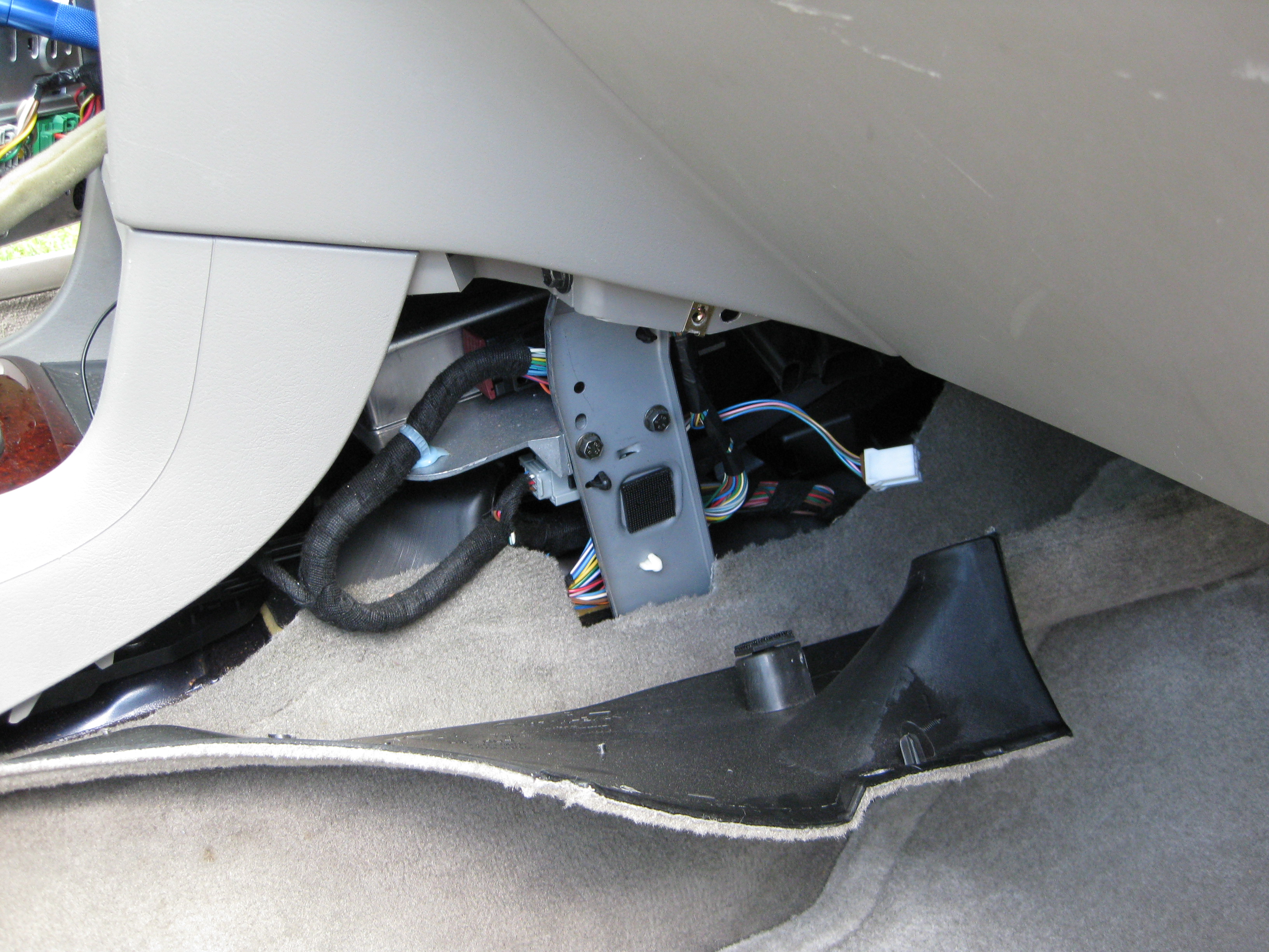

If you also remove the side panel on the passenger side footwell, you can access the damper motor for removal. You also have to remove the wires, which un-clip easily from the back of the damper motor.
