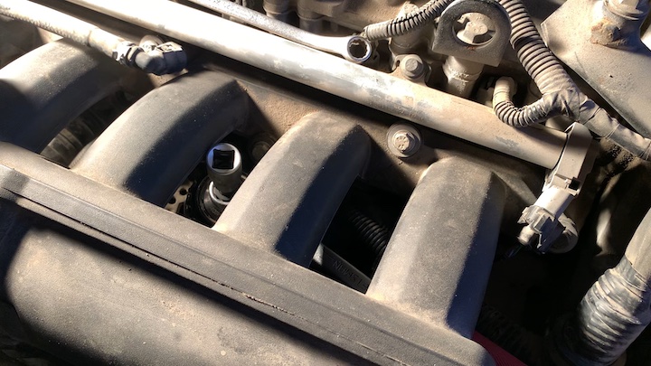

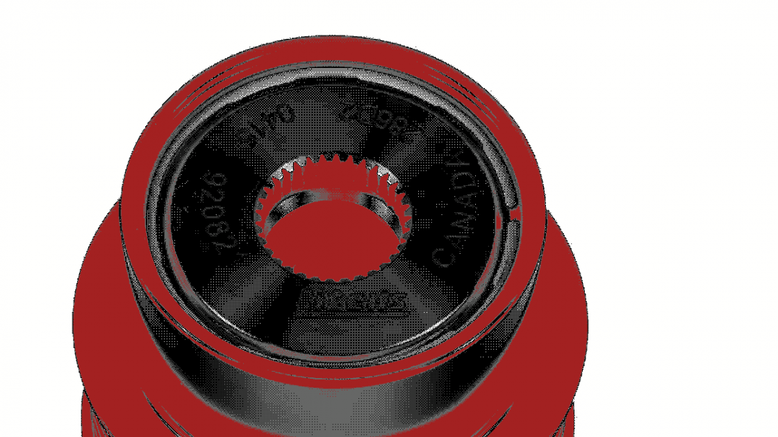

Procedure (seems long, but takes about an hour):I took a video 1/2 through (when I knew this technique would work); attached some screenshots from the video, but can upload the video if there’s interest in this technique.
It looks like many steps, but I’ve covered off all the details, so the actual in-car time is quick; this technique saves you from removing the lower skirt, lower induction pipe bolts, all 8 connectors, and 7 bolts from the intake manifold, plus you don’t have to plug that leaky coolant return spigot. Reduces risk of: cracked connector housings, dropping things into the combustion chamber, and so on. I’ve tackled this repair both ways and while this method does have a couple of tricky parts – mainly around moving the alternator around, it’s way faster, cleaner, and easier than removing the entire intake manifold.
The pulley itself is designed to spill or leak a certain amount of grease out of the pulley and into the install feature pocket (area behind the cap where the threads of the alternator are). The cap keeps the grease in, but the first time I used a mallet to install it and warped the cap – if I ordered an OEM version instead of Volvo, it would have come with instructions to just use your thumbs.
Hope this helps someone!
Tool and wrench in place for removalTool and wrench in place for removal

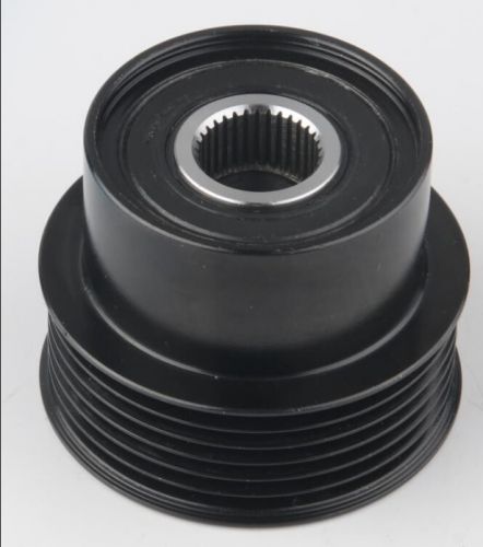

And it looks like this
over drive pulley for the alternator

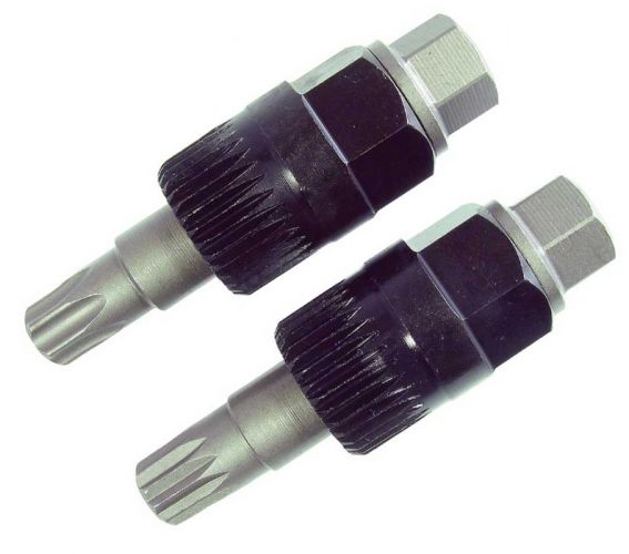

The tool that you will need to replace this type of pulley looks like this
And the over drive pulley for the A/C, water pump, power steering pump looks like this.
The same tool is used to replace this overdrive pulley.
