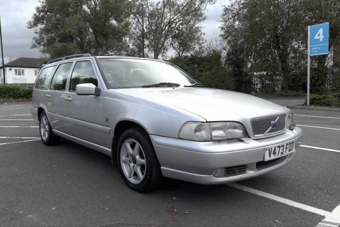

Hello, i’m considering a 1998 Volvo V70 base model, non-turbo, leather and full power options. It’s a 2 owner with 150k miles. I’ve had several 99-00 S/V/C70’s but don’t have experience with the 98. Are there any issues or maintenance concerns that I need to be aware of? Any advice is appreciated.
