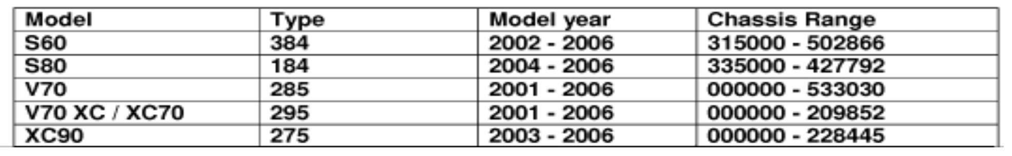

MODEL: 5cyl AWD S60 / S80 / V70 / V70 XC/XC70 / XC90
MODEL YEAR: See chart below
CHASSIS: See chart below

Note! This TNN supersedes the previous TNN 46-13 dated 2-11-2008. Additional seals and labor operation code have been added to the repair and chassis ranges have been updated.

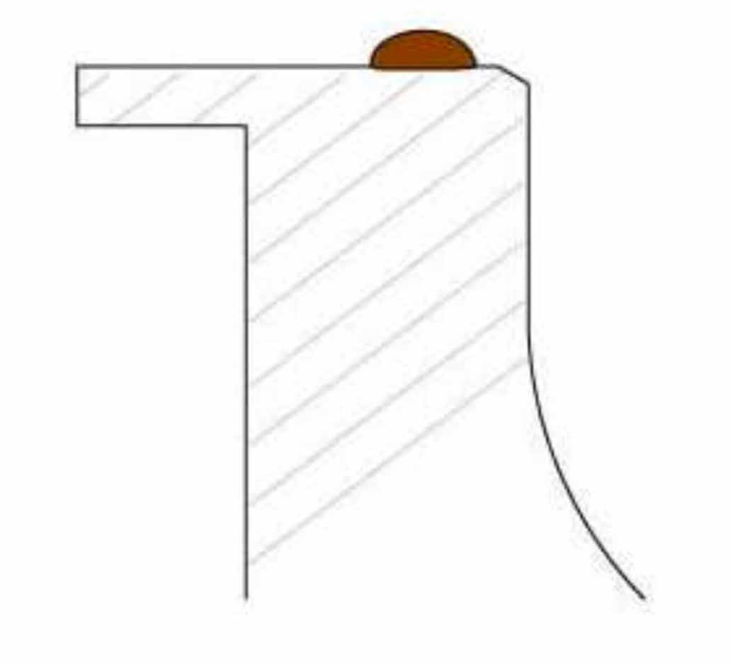

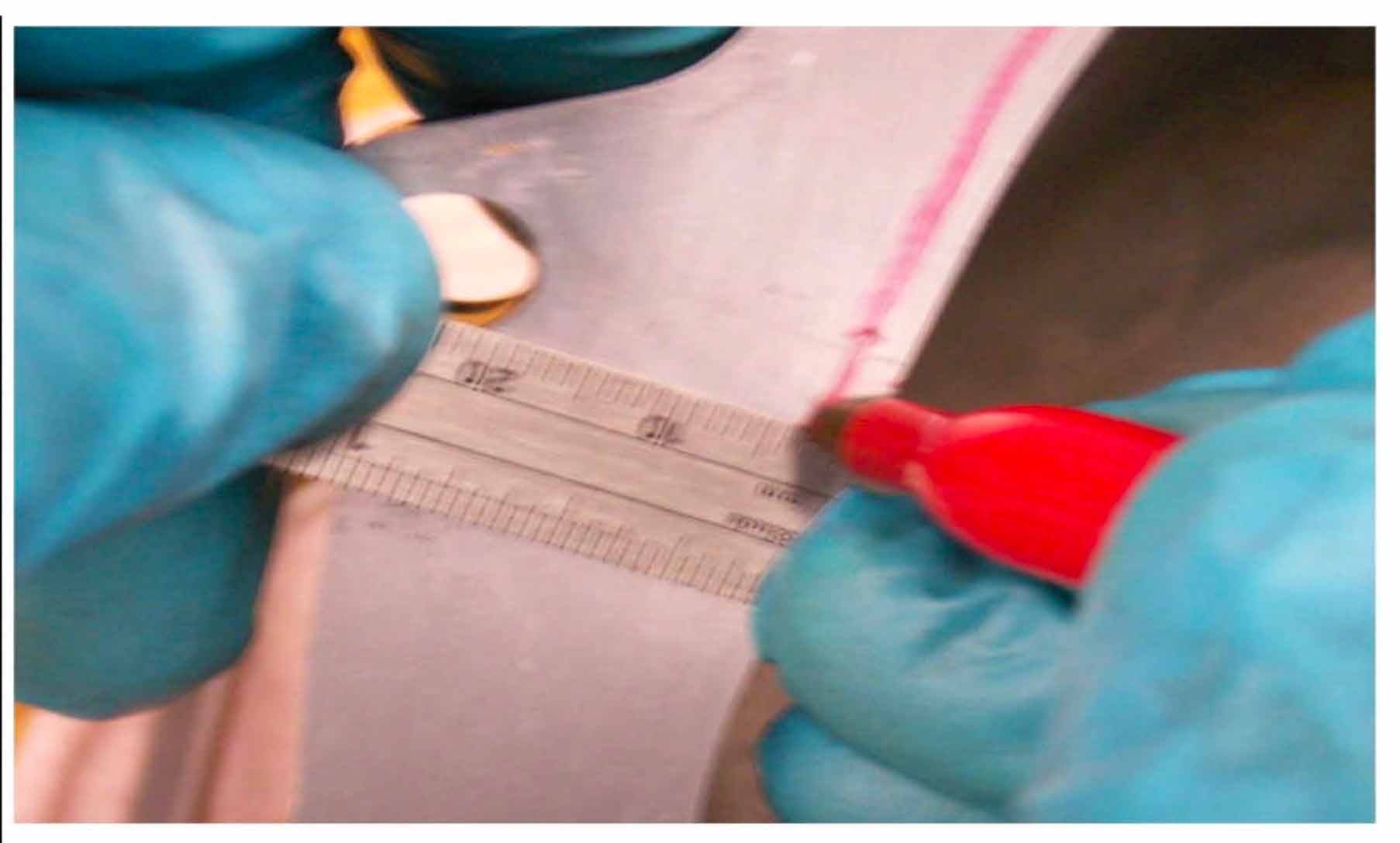

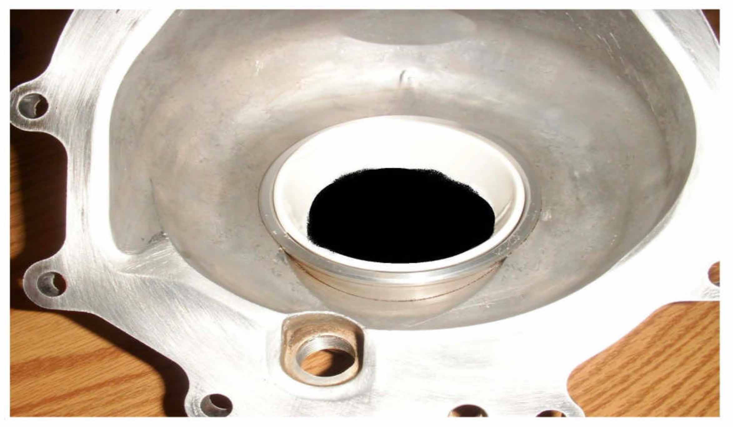

6. Measure 3 mm from the inside of the flange and make a line with a permanent marker. Note! This procedure can be made easier by making a template which can be reused for several repairs.
Angle Gear Fluid Leakage Fix 14 -

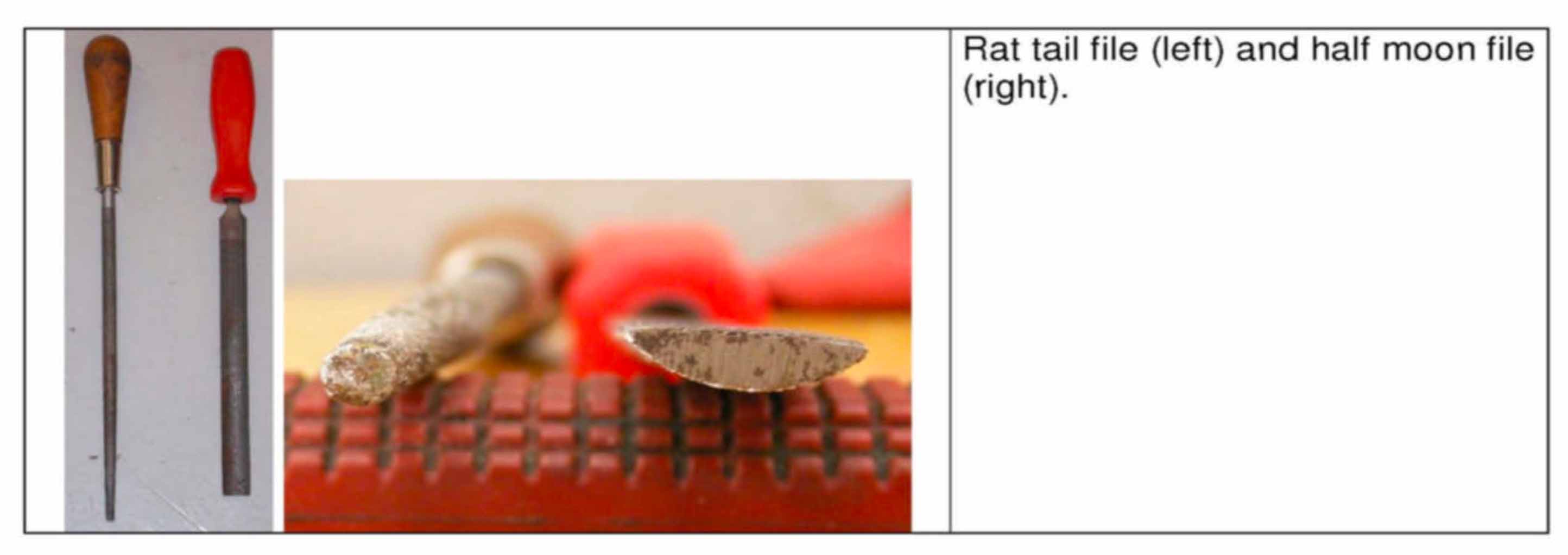

7. Caution! Care must be taken to avoid damage to the bearing race while filing. A coffee cup can be used to cover the bearing race.
Warning! Use protective eyewear.
Angle Gear Fluid Leakage Fix 15 -
8. File off the inner edge of the cover as illustrated, following the marker line, using a file. The finished product should look like this.
9. After filing, polish the chamfer using a fine emery cloth so that scoring in the chamfer goes along the chamfered edge.

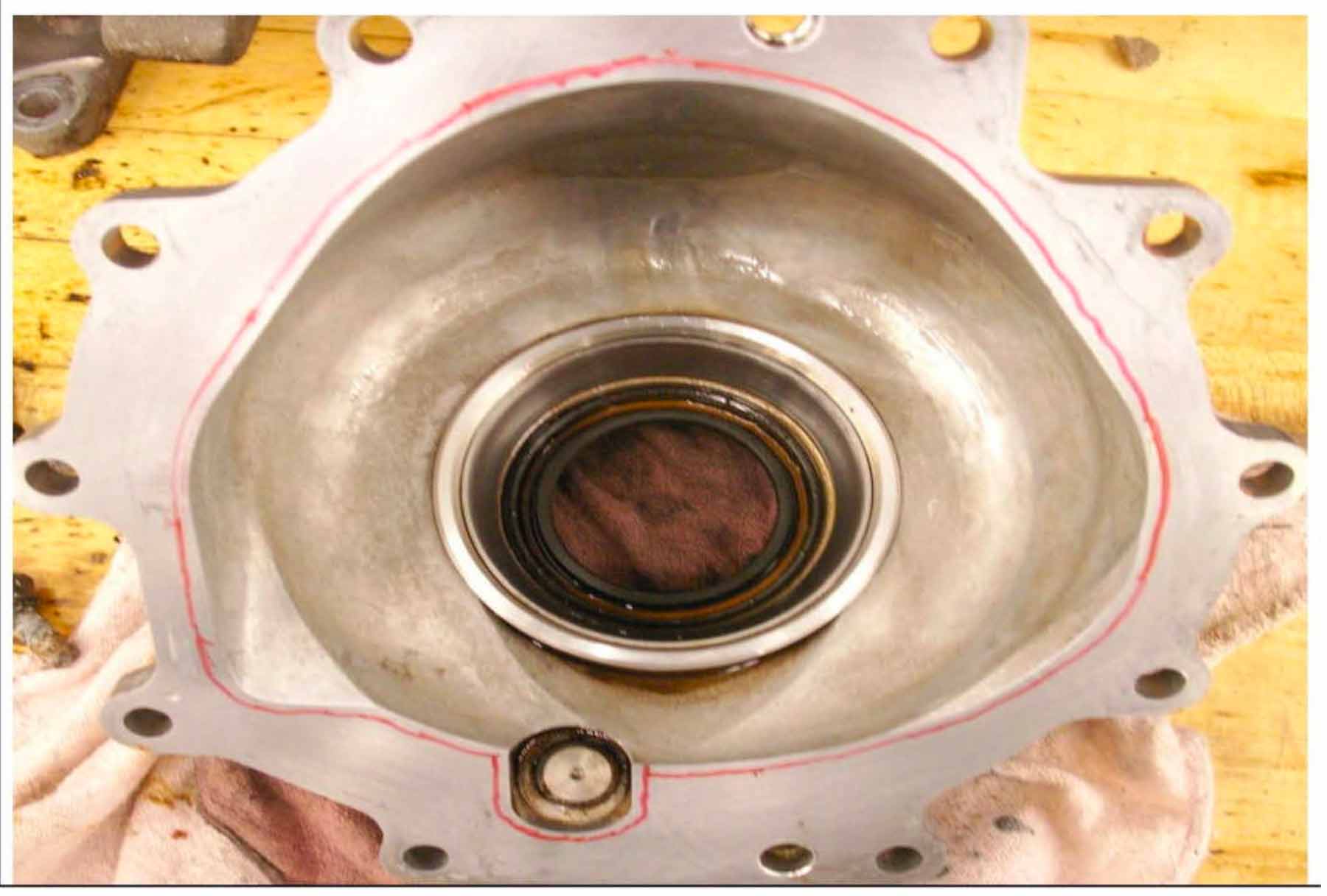

12. Apply a 5mm bead of chemical gasket 1161771 approx. 1 mm from the chamfered edge.
Note! The next few steps should be done within 5 minutes so that the angle gear halves are torqued together while the sealant is still wet.

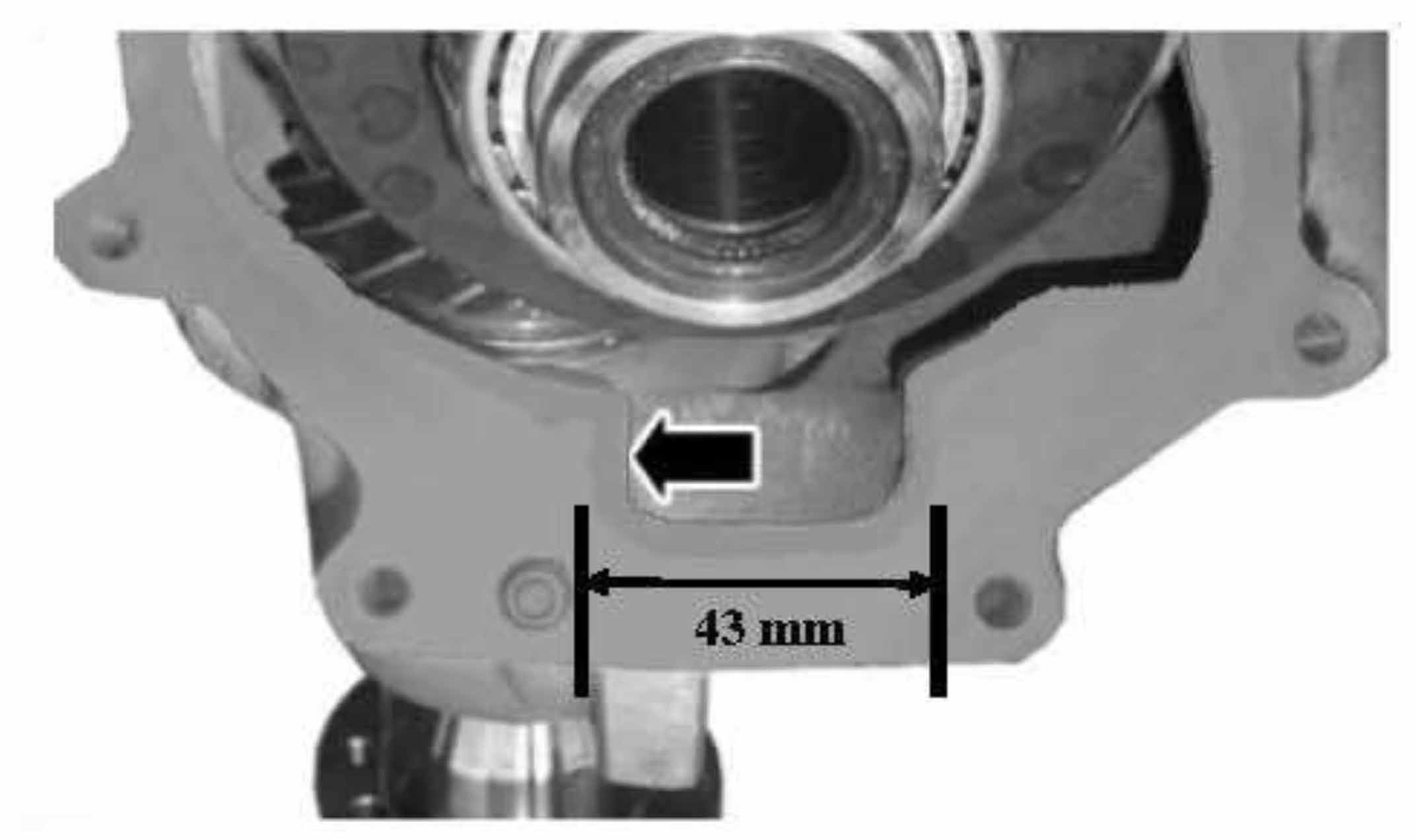

Angle Gear Fluid Leakage Fix 17 -
Pay close attention to the route of the sealant at Note 1 in photo. This is for the opening on the opposite half of the angle gear case.
Angle Gear Fluid Leakage Fix 09 -
This is the opening that requires the 43 mm spacing in the silicone Do not apply sealant to both halves.
Angle Gear Fluid Leakage Fix 10 -
13. In order to aid in installation and to avoid affecting the silicone bead when reassembling the cover, set the cover over the locating pin marked “1” first, then carefully lay the cover down to lay flat on the flange.

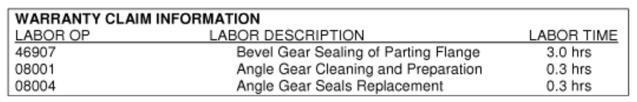

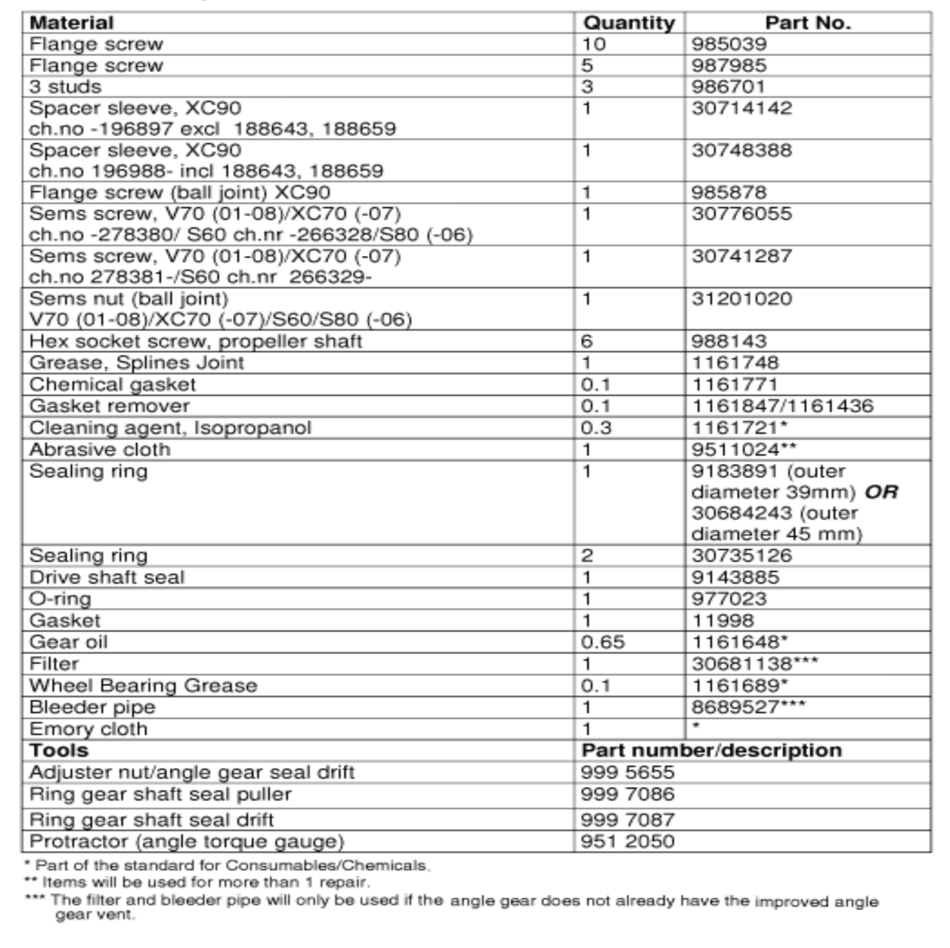

16. Fill the angle gear with 0.65L of oil P/N 1161648. Install new drain plug gasket P/N 11998. 17. Install the angle gear according to VIDA.
Note! New screws must be used to install the angle gear to the transmission.
