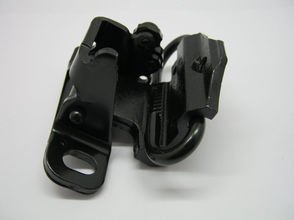

My door made a loud cracking noise every time I opened it. This went on for several months but never really got any worse. I guessed it was a problem with the spring mech in the stay itself, so I figured I would replace it when it failed altogether…

I don’t know if it’s called a detent, but the little arm the holds my driver’s door open has failed and the door tries to close on me on slight uphills. This looks totally ghetto. Is this a bolt-on part, and where can I find one?

Thanks for all the ideas. I am going to try this repair with a couple modifications to try to simplify it. My idea would be to ,once you have your 2 holes drilled out in the door jamb ,measure your center to center spacing of the holes. Next get a flat piece of flat steel and drill out 2 holes with the same center to center spacing. Next tap 2 threads into the steel plate to accept your 2 bolts. You then can feed a wire down through the top hole in the plate and down through the top drilled hole in the door jamb and let the plate slide down so the holes line up. Next you then can install the bottom bolt and snug it and then pull the wire out and install the top bolt, nothing will spin because the plate with the 2 holes will prevent it spinning like a nut would
