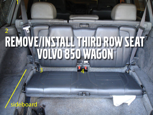

The majority of this job involves removing the seat belt by detaching at the three anchor points (1, 2 and 3 in pic) and the seat belt buckles (4 in pic):

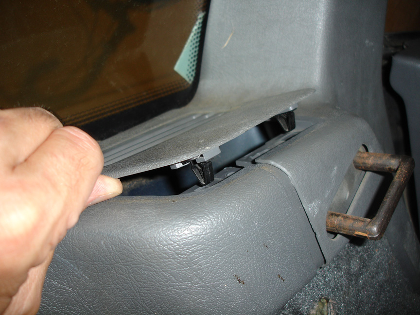

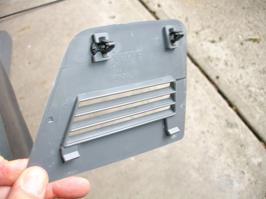

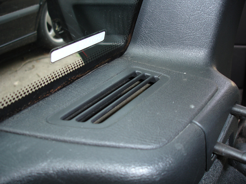

– Remove the plastic seat belt “vent” at the wheel well. It tilts up and toward the window like a hinge, and then lifts right out.

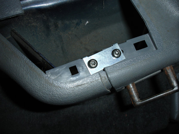

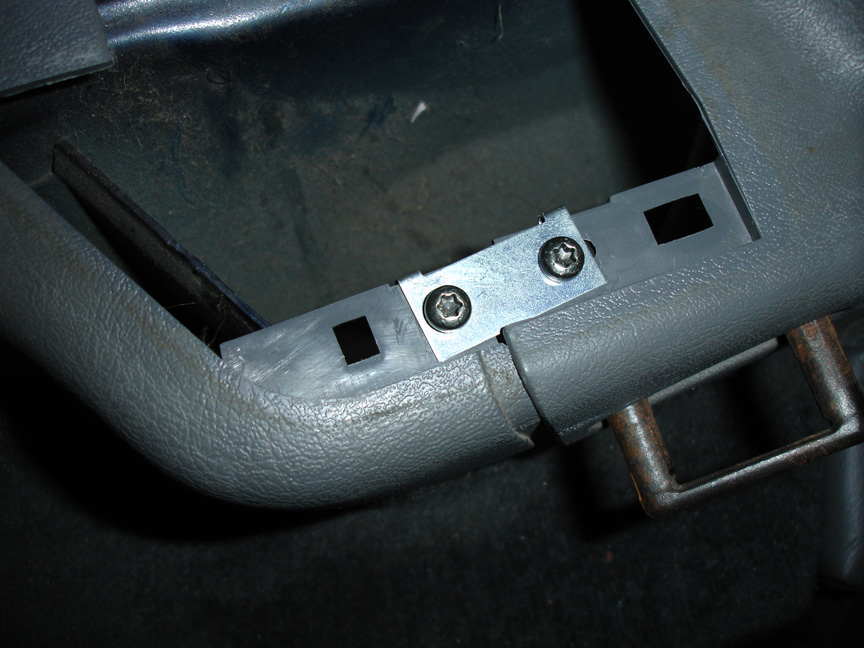

– Under the “vent” insert, there is a silver bracket that couples together the two trim pieces. Remove the 2 screws (torx T25) and remove the bracket.

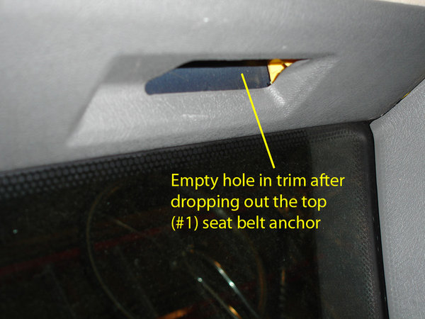

– Detach seat belt anchor #1, at the roof: remove the 14 mm bolt (keep the thin, yellow nylon washers on the mounting bolts), and then the anchor drops through the hole in the trim.
