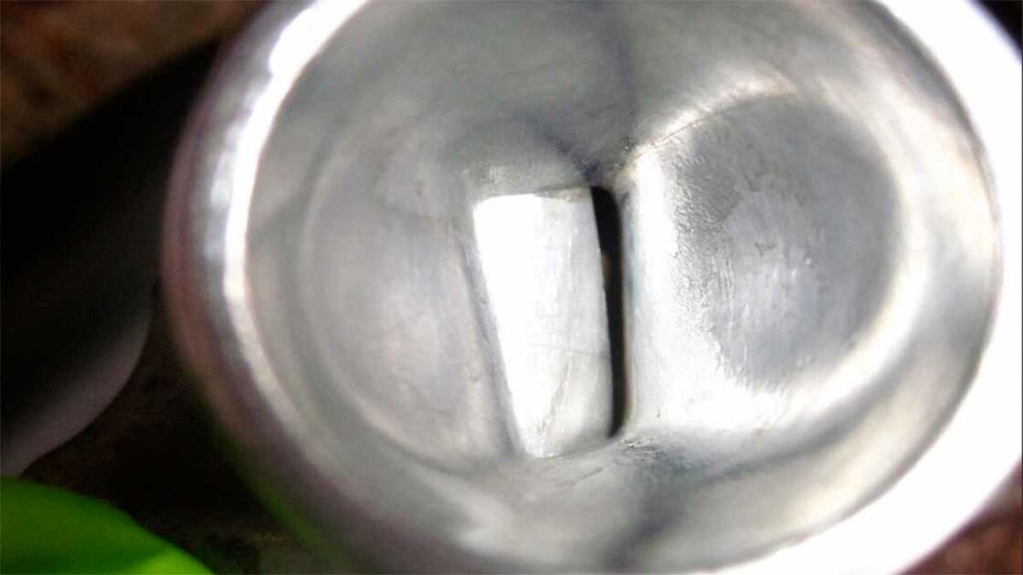

Remove the Oetiker clamps at the IAC connectors. Inspect and clean internal plate. My IAC valve was original (dated ’96) and had never been cleaned as far as I know. There was a lot of yellow and black varnish on the plate that needed to be cleaned off. I used MAF cleaner (hexane) which was not very effective at dissolving the varnish. I used cotton swabs and a flat screwdriver blade to wipe and scrape the varnish off and used the MAF cleaner to flush away loosened deposits. I think the varnish had built up to the point that it caused the IAC valve to stick or respond slowly, making the idle wander and the car likely to stall. If you twist the IAC in your hand the plate should rotate freely. IAC valve with ~15 years build up of varnish (pre-cleaning)
After cleaning, twist the IAC to make sure the internal plate rotates smoothly without sticking or binding. During reinstallation I used new hose clamps to replace the three Oetiker clamps I removed. While I had the intake hose removed from the throttle, I took the opportunity to clean the throttle plate. After putting the IAC and hoses back together, the car is running well again. IAC valve after cleaning. This worked great for me and was a lot cheaper than buying a new IAC (~$200). If I had to do it again, I would probably have bought some more powerful solvent like throttle body cleaner to make cleaning out the varnish a little faster and easier.
