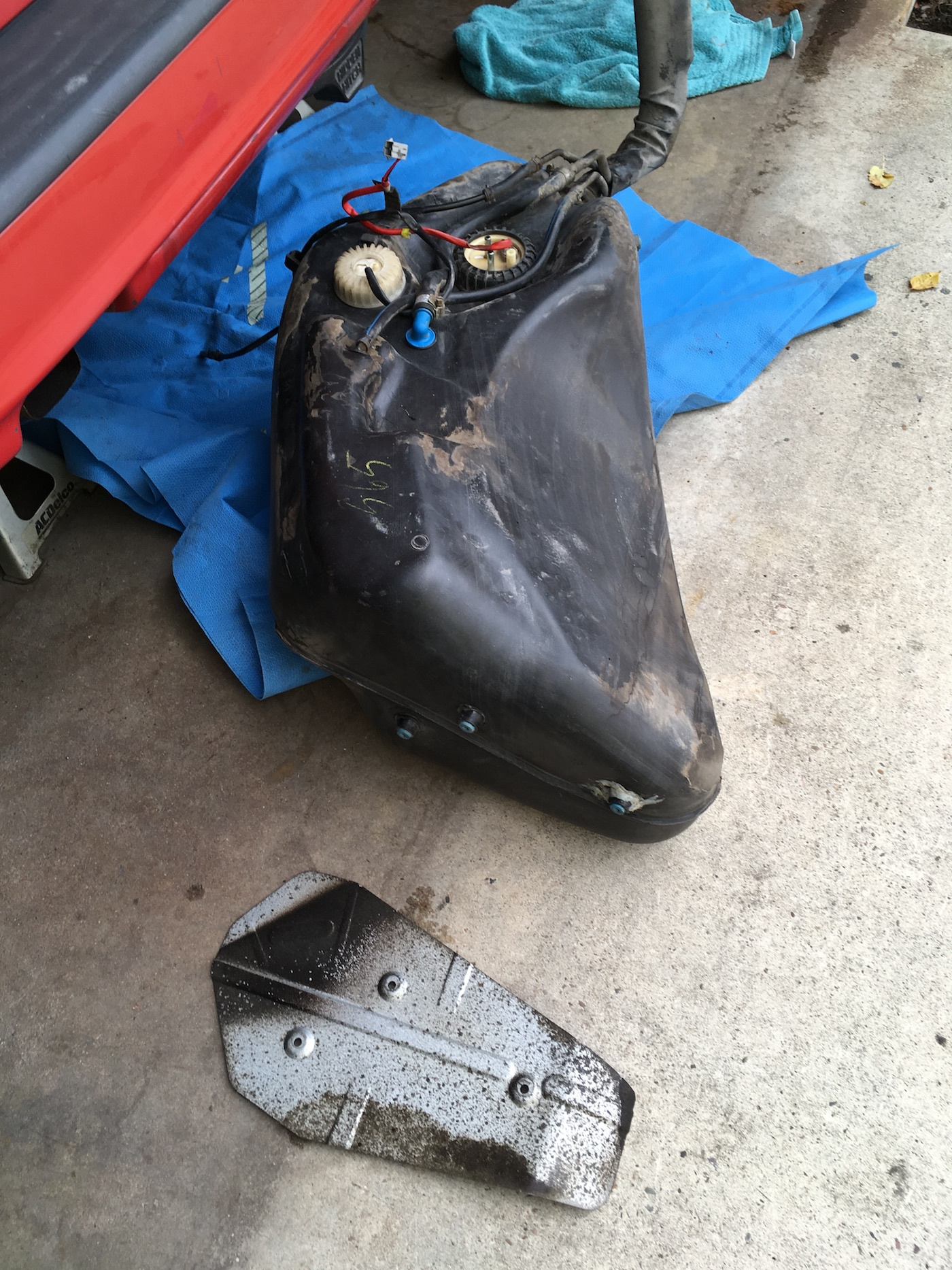

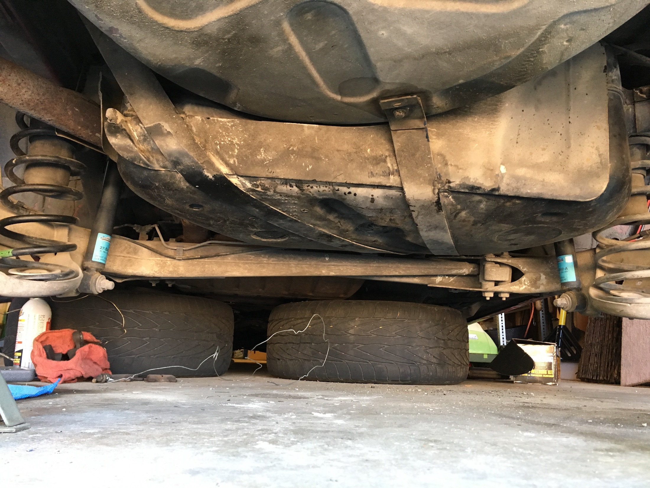

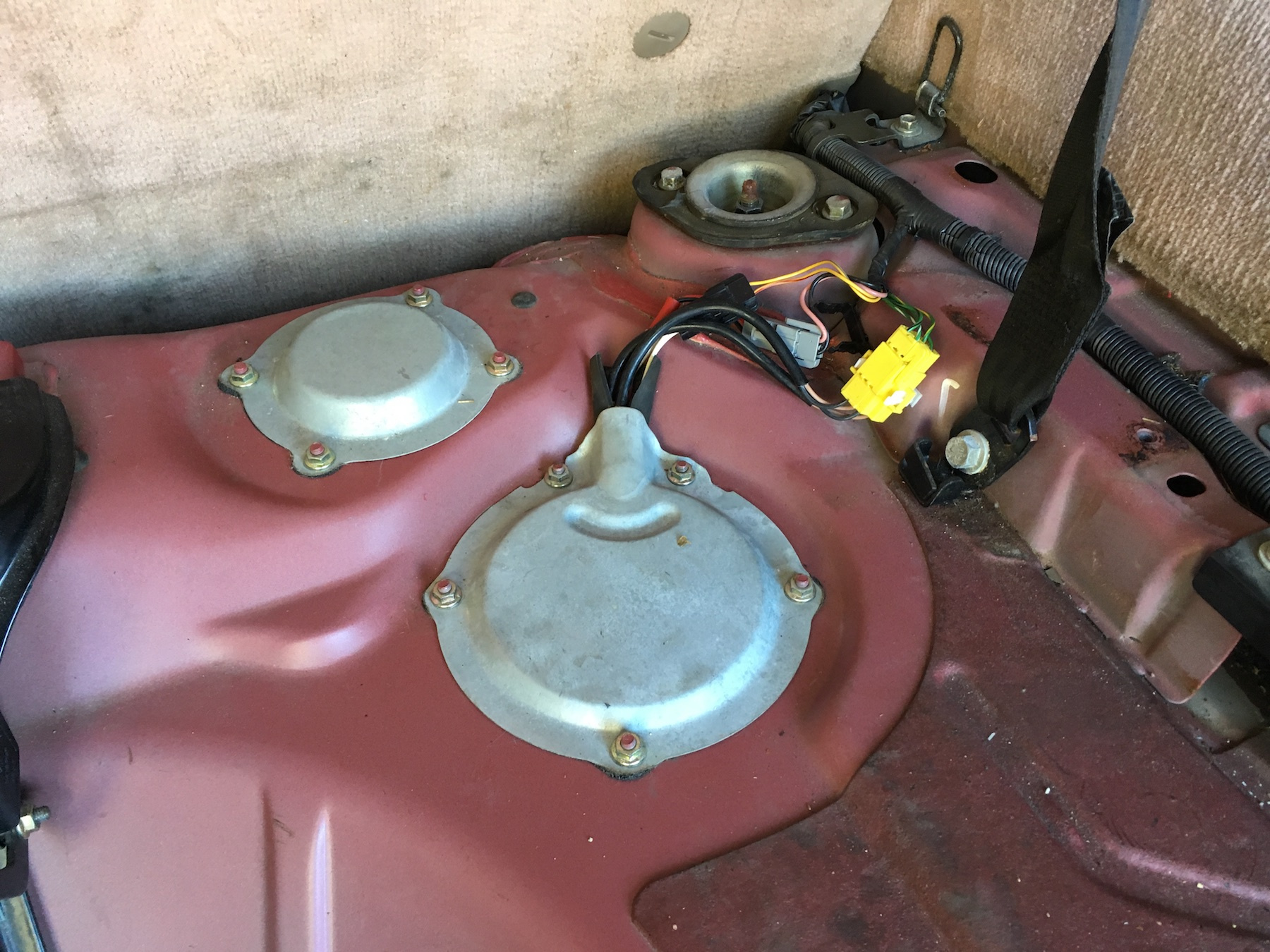

MVS Contributor BlackBart » I installed the repaired fuel tank – not too heavy but a lot of jiggling and wiggling around to get everything aligned right. Then got that rubber boot through the body shell and attached. Replaced a cracked vent hose. Ready to fill up.

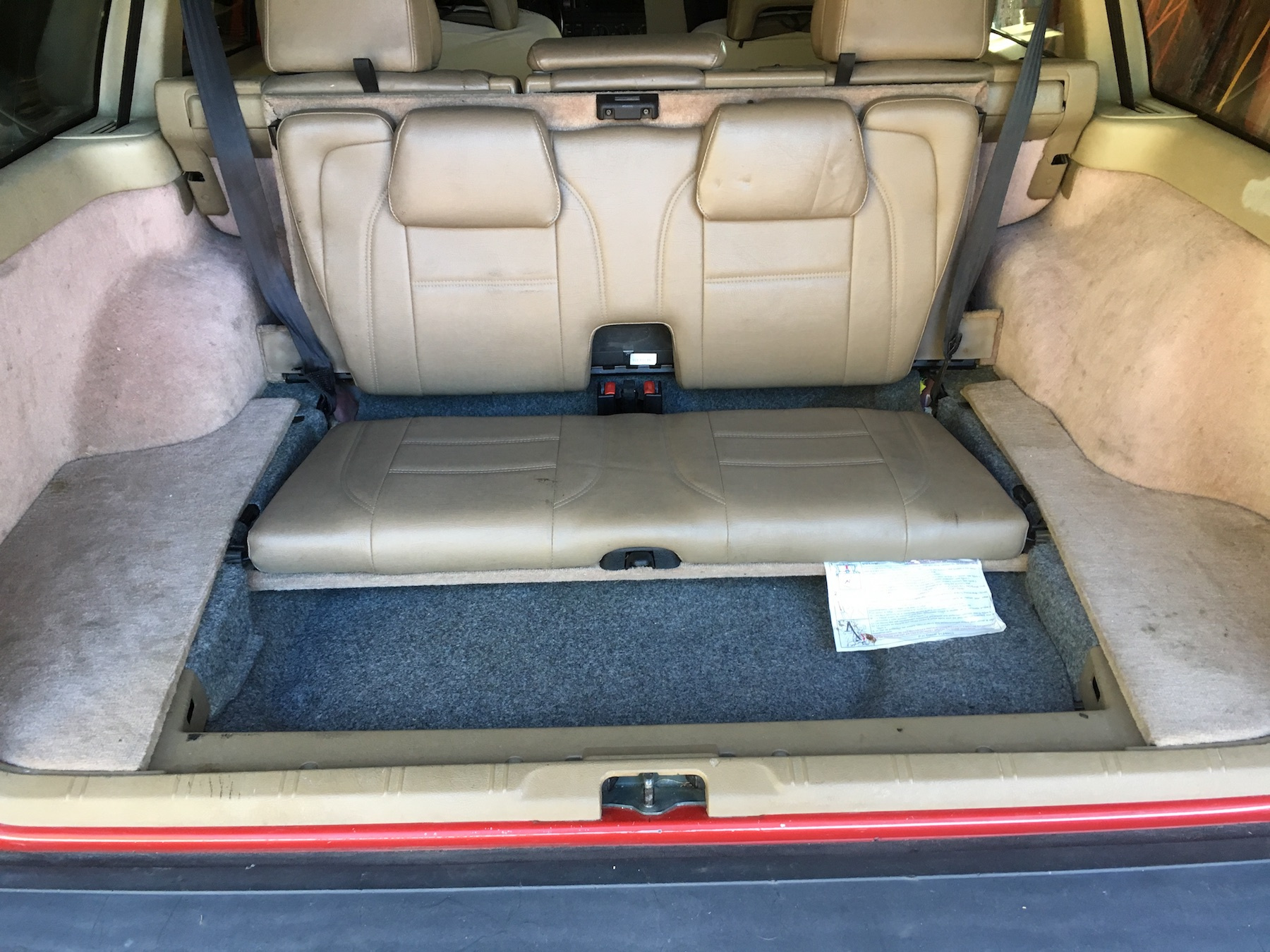

Re-remembered how all the rear floor bits bolt back together, and the original unused third seat!

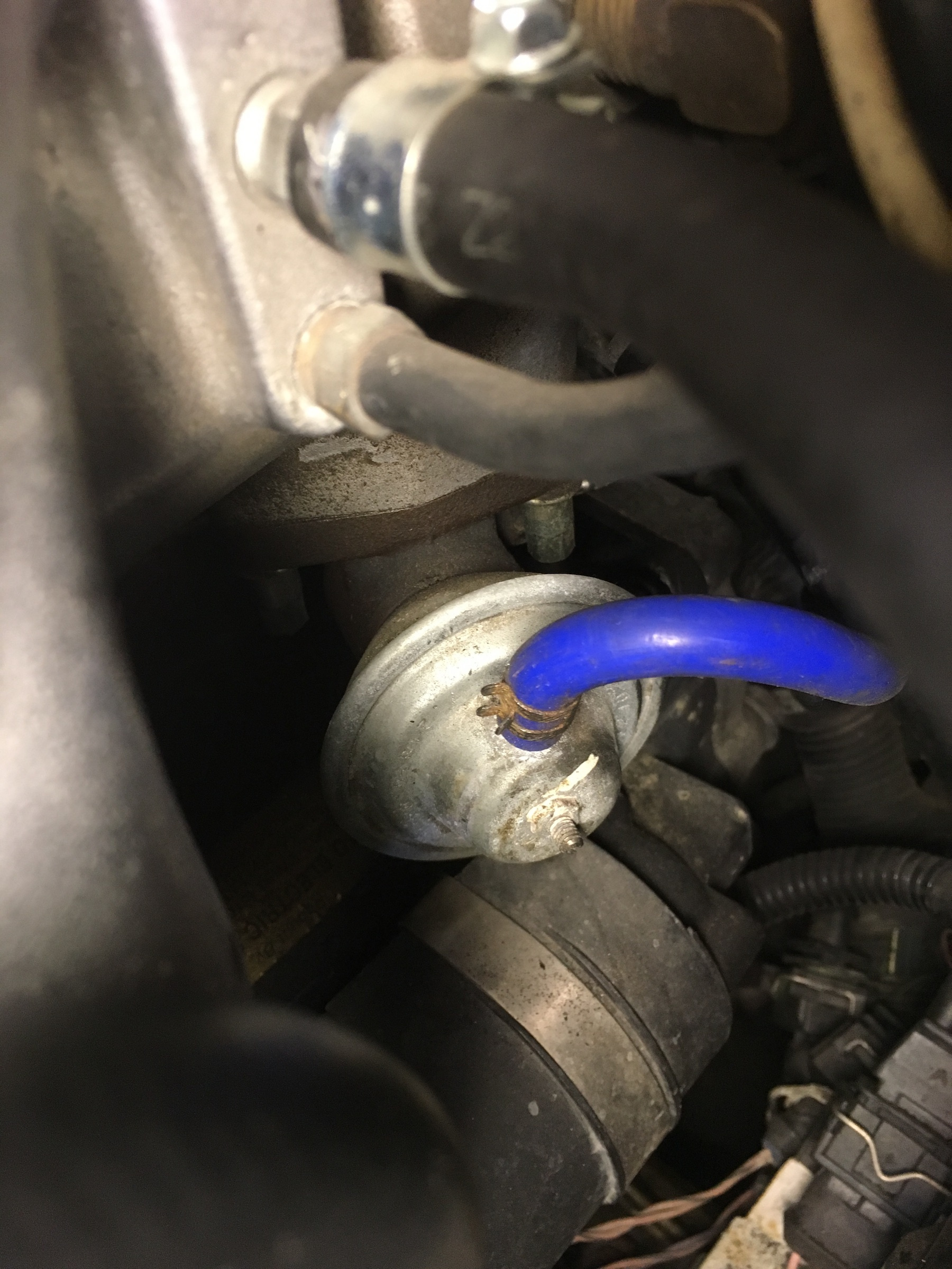

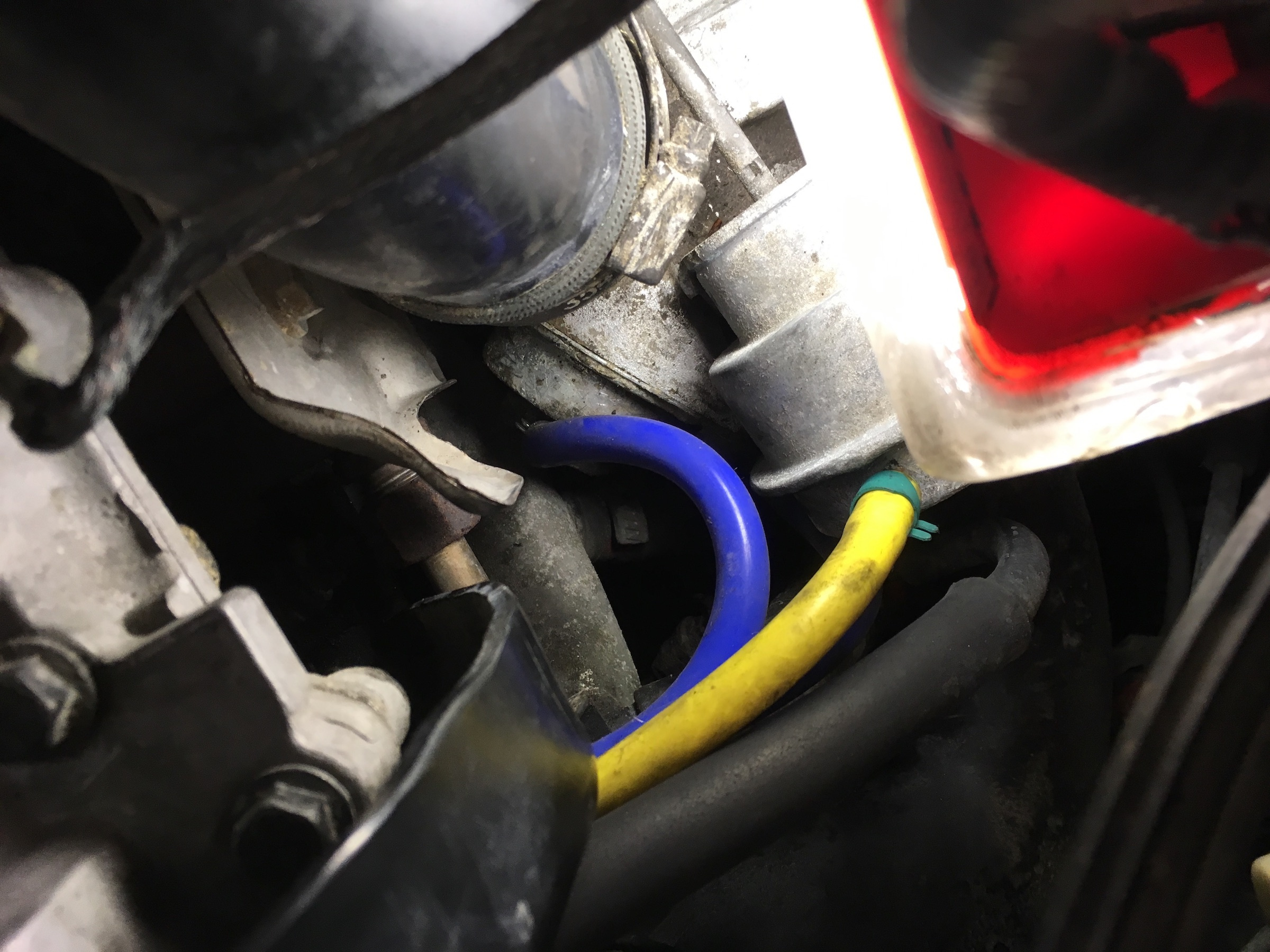

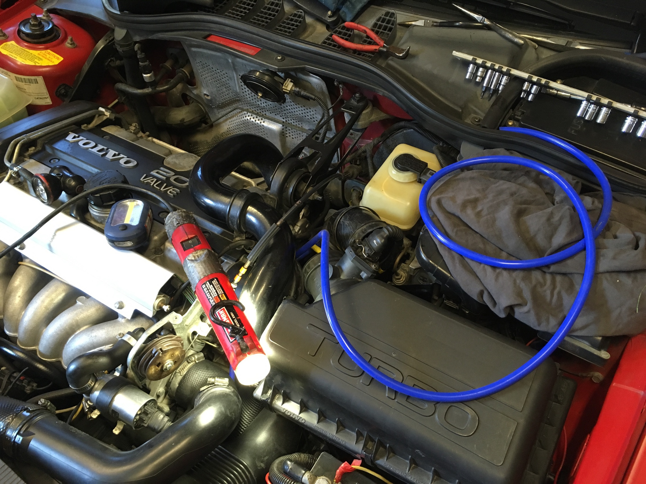

Managed to get that fourth vac line snaked through and connected – turbo housing to EGR valve. Did the other three turbo control lines a while ago and forgot this one – or avoided facing it. But not so bad really. Good light and a long needle nose pliers, and move some turbo hoses out of the way. (Note: The little squeeze clamps that come with the ipd silicone hoses will be too loose – use the old ones from your old rubber hoses)

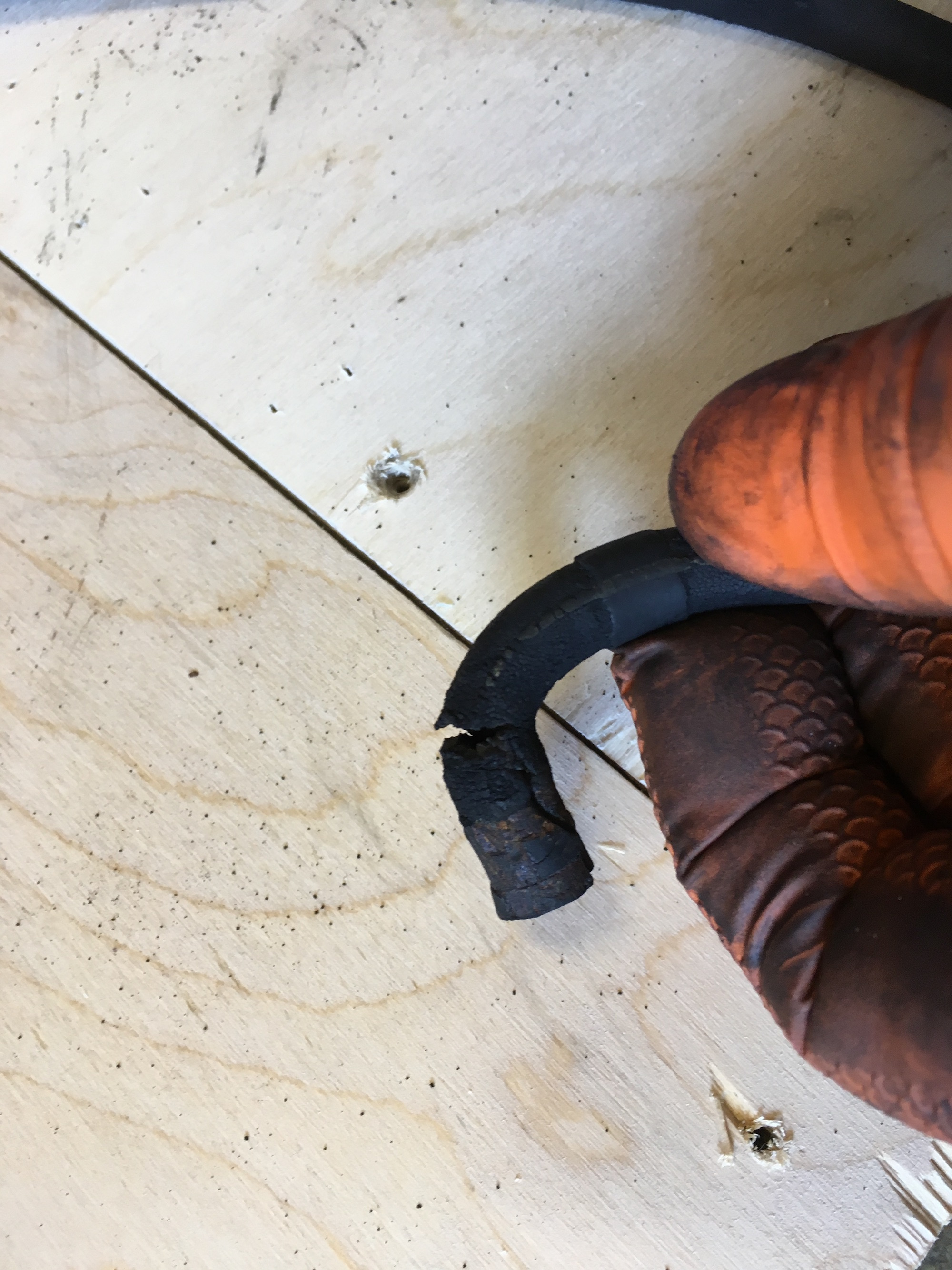

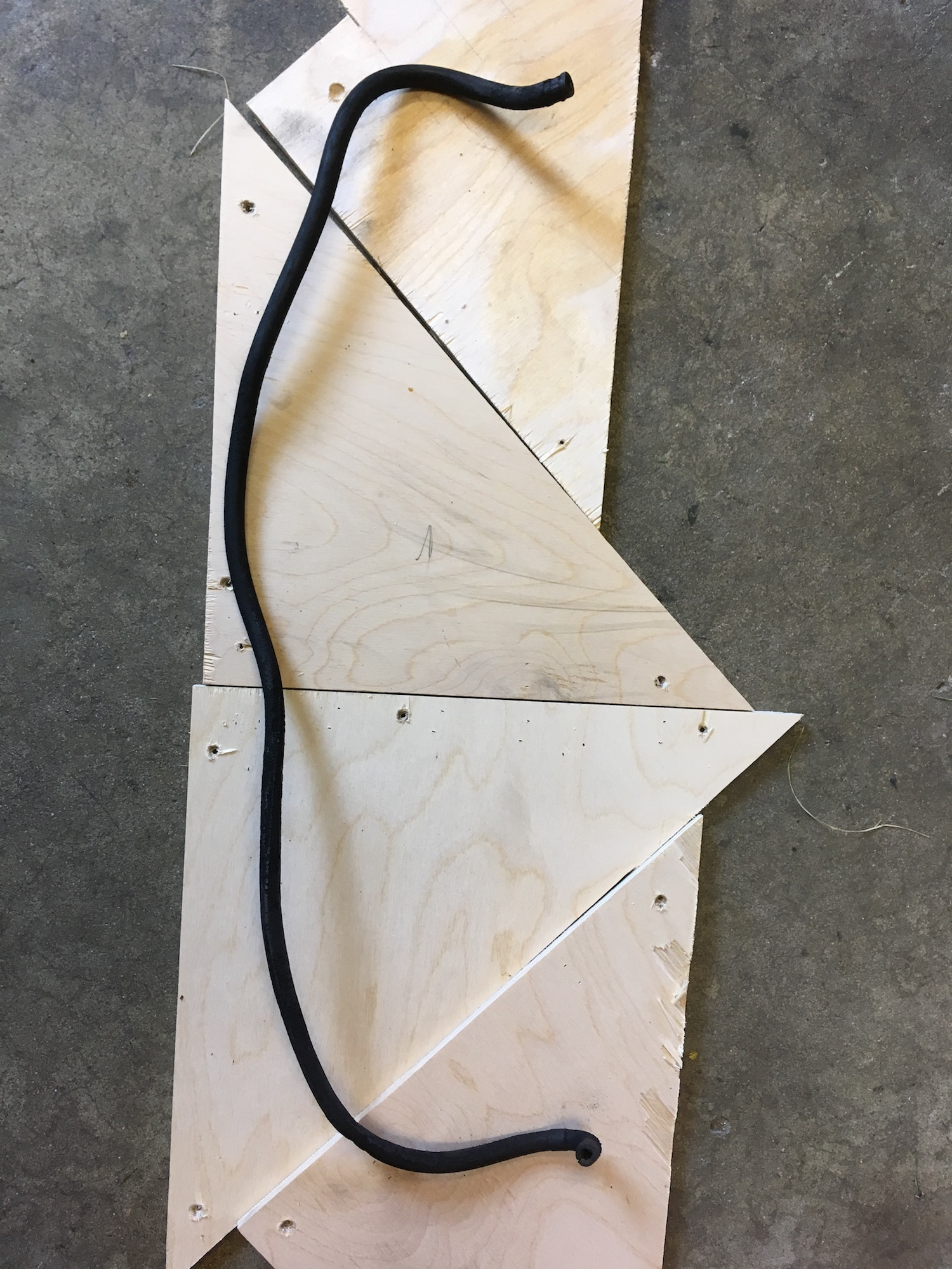

Came out intact…..but with cracks at the bends. Was it from me yanking on it with a pliers, or already cracked?…hmm. I had an “EGR Flow Too Low” code for forever, could this be it? I’ve tested EGR, cleaned it, checked the intake port etc etc. We’ll see if this solves it.
