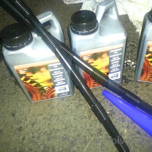

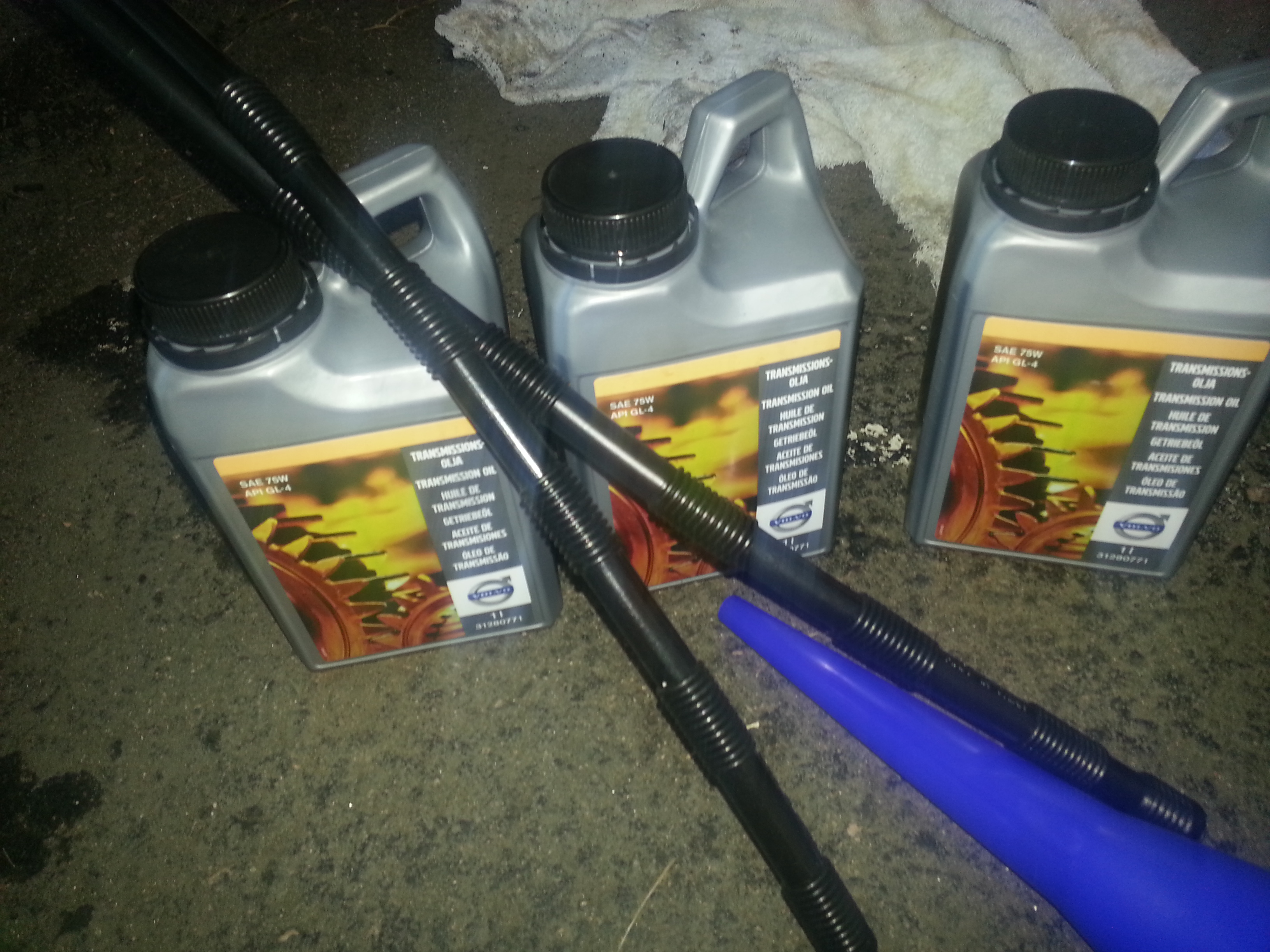

What you are going to need:
1. 2 liters of Volvo Transmission fluid #31280771
(I’m not going to argue about OEM vs Brand X. I did my research and if this is what my mechanic uses (fanatical Volvohead) for his M56H tranny, then THIS is what I use.)

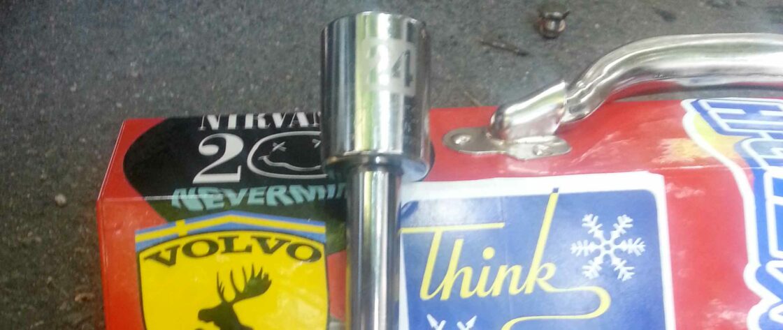

2. A 24mm Socket
3. A 24mm Wrench
4. A socket extension at least 10 inches long
5. A funnel and tubing or a pump of some kind
6. A large oil change container.
7. A lot of rags.
8. Jack.
9. Jack stands.

Next place your oil change container under the drain. If you are not interested in making a mess like I did I would advise placing a funnel under the hole because the fluid is going to hit the frame, spread across it and cascade off of it. So pull the plug out and let the fluid drain. While it is draining I took out the fill plug. Mount up your 24mm socket to your extension and go at it straight through the wheel well.
