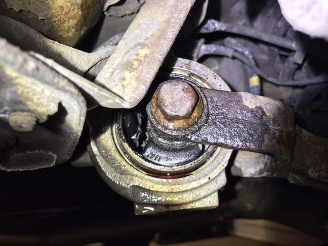

I’m sure lots of you have looked at the various moving parts in your rear suspension & have noticed there’s so many things connecting this to that, and that to the subframe etc. Amazing how it all works, well sort of works. You’ve also probably noticed torn bushings at the front attachment point for your trailing arms.
Rear subframe trailing arm bushing
For the longest time I just thought the area where the tear is plainly visible on the front & rear of where the bolt passes through was there for a reason; to allow movement as the suspension travels up and down. Well looking at the new bushings there really is no way for them to allow for as much movement as the bushings these cars originally came with.
My theory is that the old bushing allowed for, over many years of use and hundreds of thousands of push/pulls, too much movement, and as a result the loosey goosey rear end feel. I’m open to ideas here, but to me, the way the original bushings allow for this movement creates a condition where toe is constantly varying depending on how far the rear suspension is compressed or extended. Is that the loosey-goosey I’ve had my finger on the pulse of?

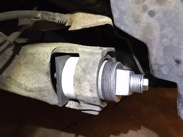

Here’s the press tool I rigged up. A few 2” PVC repair couplings, one of which you cut in half (have a couple spares in case one cracks), a modified 2” galvanized plug, 7/16” grade 8 bolt, washers that fit on it, nut, and a couple steel plates cut & drilled to fit. I used a coarse thread bolt & even after doing (edit) 8 (technically 16) bushings with the same bolt and nut the threads hadn’t deformed at all. The 1/4″ plate actually bends inward towards the 7/16″ hole on the really stubborn ones, so flip it over when you start to notice it becoming concave. If anyone wants to borrow it just gimme a holler.
Making the bushing press tool
Bushing press in with the custom tool
A tool for in-situ rear trailing arm bushings
