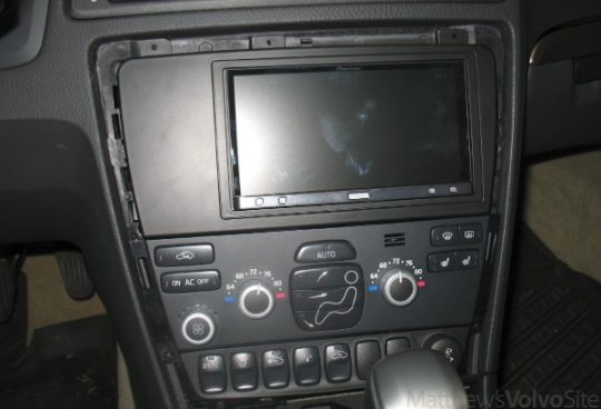

The stock head units aren’t all that good to start with and have that pesky ESN on them. Why they did that is beyond me. My advice…. aftermarket head units are far superior in quality and FAR cheaper. Best of all, any aftermarket speaker you use will work without any issues.
