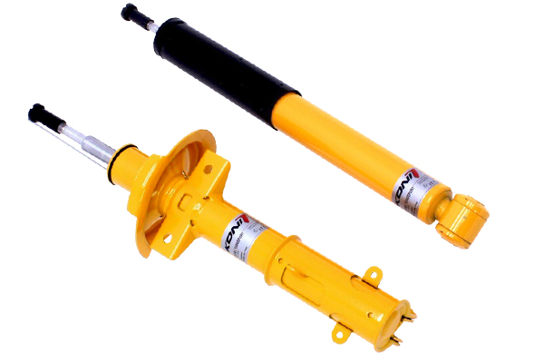

- The replacement struts are Koni STR.Ts. Once I get some miles in, I’ll provide my opinions, since they don’t seem to be well-known on Volvo sites. Koni claims they’re the equivalent of their yellow Sport struts set at the softest setting, which is a popular recommendation for a daily driver. At $320 for all four (Tire Rack), it’s hard to justify buying a cheaper strut. I should mention that the orange paint on the STR.Ts seems very soft, so maybe build quality isn’t quite as good as the yellows, but it’s half the cost.
