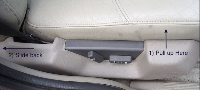

So the seat switch assembly is actually pretty easy to take off once you release the plastic zip ties holding it to the frame.
1) Look under the front edge of the seat and you’ll see the control wire fasten by a few zip ties. cut those and you’ll be able to release the whole assembly.
2) Lift the forward part of the seat up and then slide back to release.

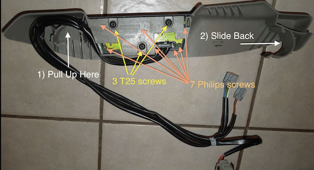

From the back side, you can see the circular areas that clip onto the seat and hold it all in place.
From the picture above, you can see the location of the screws.
3) Remove the T25 screws and you can slide up the whole assembly.
4) You’ll have to cut two more zip ties before you lift the switch out of the housing. Remove the switch housing and you’ll see some philips head screws.
5) After you remove the philips heads screws you’ll see the micro switches.
