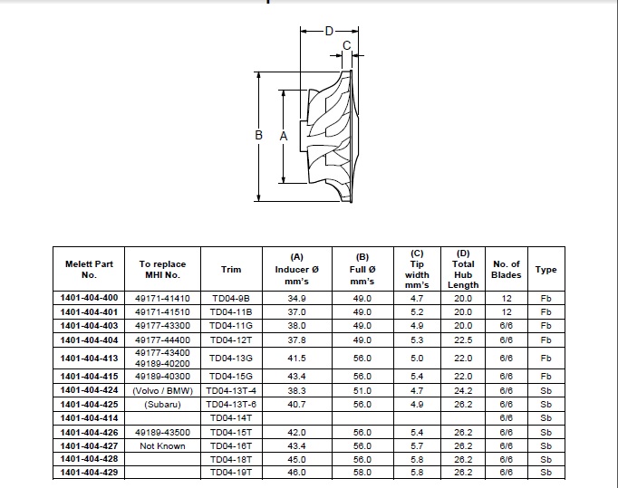

“TD04-HL turbos (13G, 13T, 15G, 16T, 18T, 19T, etc) have all the same turbine wheel.
All four type of Volvo turbocharger turbine housings (conical/flat/small port angle/large port angle) are interchangeable between all TD04-HL turbos.
Center section are all the same, early ones have coolant ports on both side, later ones have coolant ports on the same side ports for coolant. Holes are all there, they just need to be tapped if you want to use different coolant port.
Yes, rspi is right, you can swap between turbo physically and most people with their stock cars will probably never notice.
To OP, you can use TD04-HL 13G, 13T, or even a commonly found 15G from a 850. Just keep using your turbine housing. Running at stock boost, I highly doubt you’ll notice any difference.
Now, to show I know what I’m talking about…
Conical, flat, small port angle, large port angle.”
