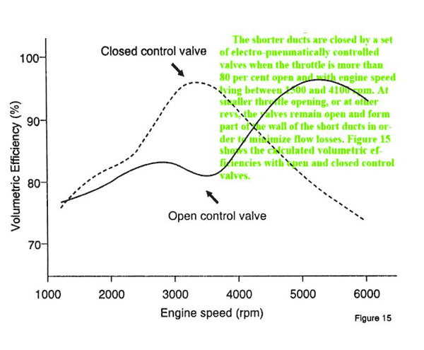

The 20V non turbo models had a variable inlet manifold, to increase engine efficciency. Well this topic is all about the control of this manifold and how to improve the behaveour of the engine.
OK you will reach not more bhp’s but much better behaveour and performance in low revs.
Let me explain:
While reading the original design documents, I arrived at something interesting about VVIS (Volvo Variable Induction System). Please read carefully:
vvis theory

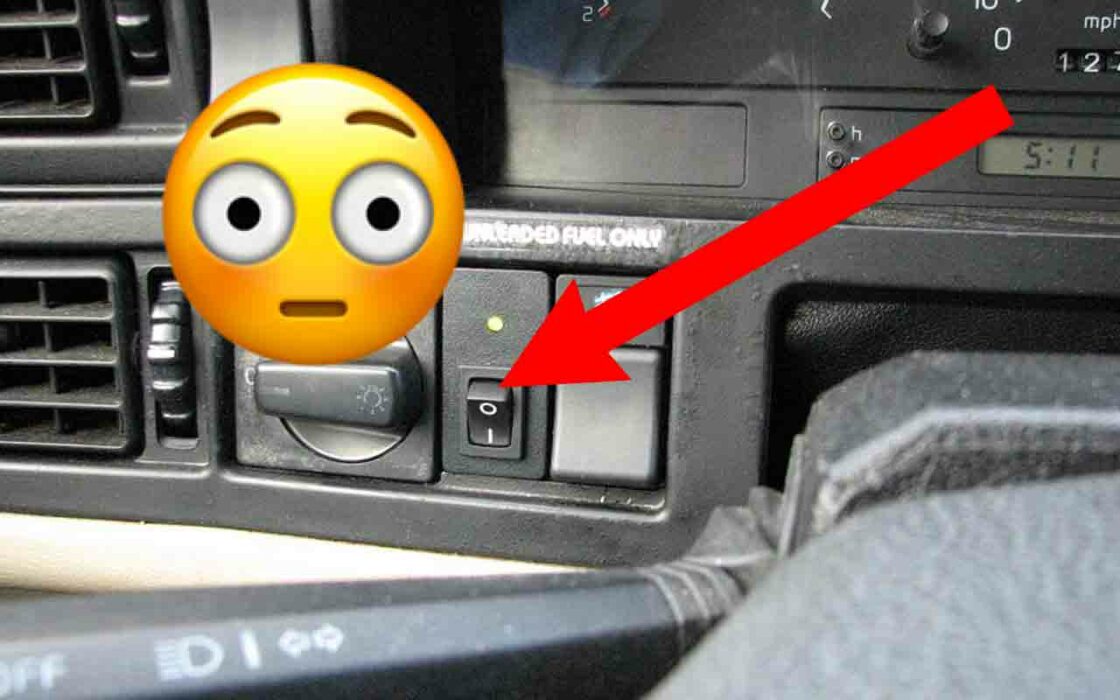

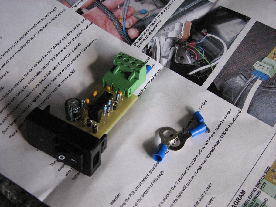

In summary, I think it was the most pleasurable outcome to ask for. This was money well spent for the immediate return, and the project itself was not difficult. Actual time working, approximately 2 and a half hours. More time was spent thinking through the routing of the wire, but once it came to me it went fast. And I took Photos.
So if you are dealing with a VVIS equipped setup. I can highly recommend this little box.
Yitsbox

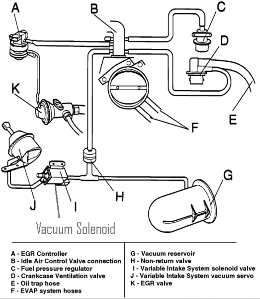

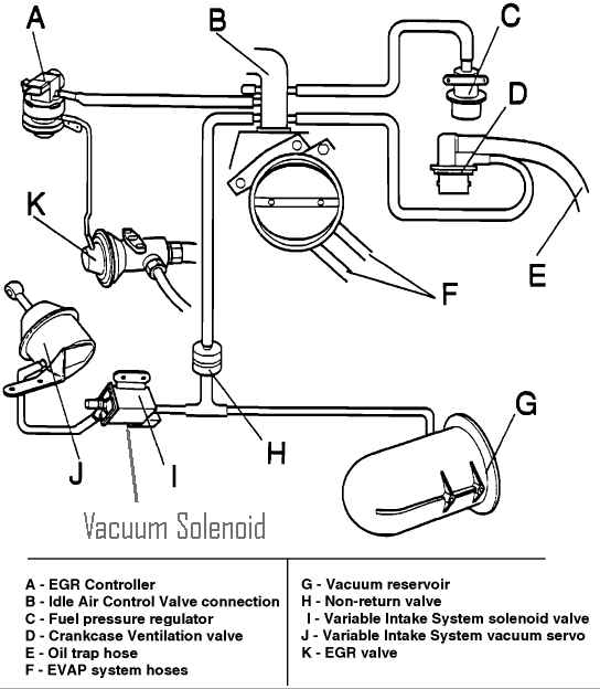

Vacuum solenoid
