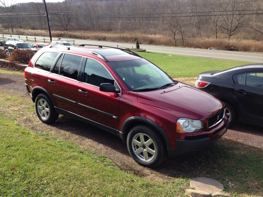

RedGeminiPA » November 17th, 2013, 8:34 am My first post, and this is a good topic.
I picked up my first Volvo yesterday. It’s an ’04 XC90 2.5T AWD (154k miles) with Climate, Premium and Versatility Packages and Bi-Xenon headlights (those headlights are pretty amusing, though not the greatest in function). I think it has the Security Package, but I’m not sure how to check for sure. I’m also not sure how to check to see exactly which sound system it has.
http://www.motortrend.com/cars/2004/vol … s_options/
When I first spotted it for sale at a local small used car dealership, I immediately started doing research.
I have no idea what its history is, but the dealer did have to tackle the leaking sunroof issue before I purchased it. I witnessed them thoroughly drying out the carpets and sealing the drain tubes, so I’m not concerned at the moment. I will, however, be working to modify the drains in the near future to make sure the problem is resolved as best as possible. I did have it checked over by my mechanic/garage before placing a deposit on it last week. Tires and rear brakes were the only problems found.
They replaced the tires and rear brake pads and rotors, and had the state safety inspection done.
When I went to make the purchase yesterday, the battery was nearly dead and needed jumped. Now there’s a warning to Service Security System. I read a tip I’ll have to try. A new battery may be in order.
