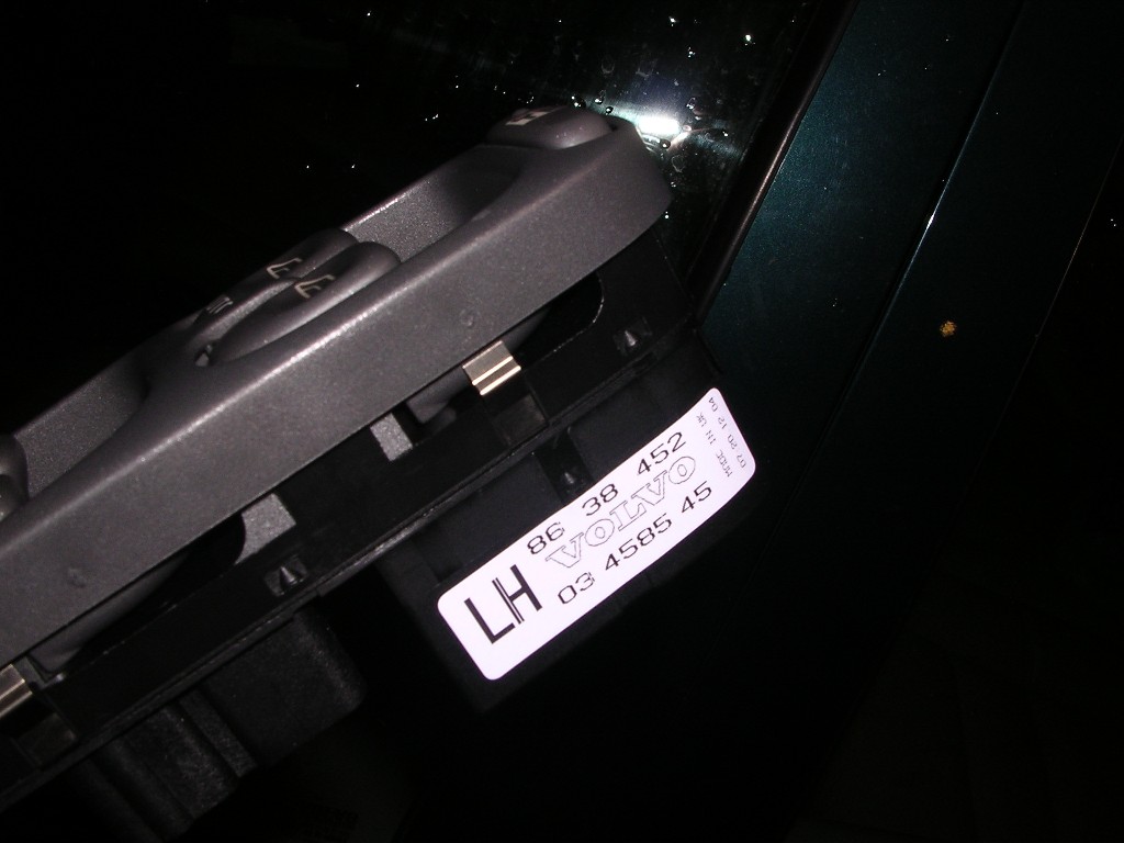

The picture below shows the label on a new switch bank I purchased.
Replacement window switch assembly Volvo S70 V70
