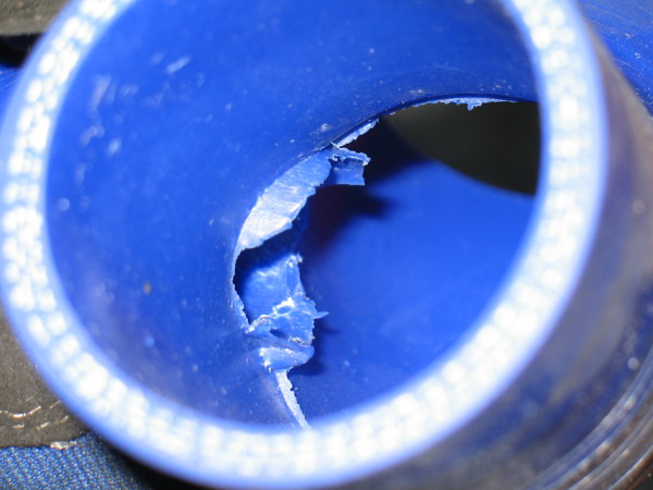

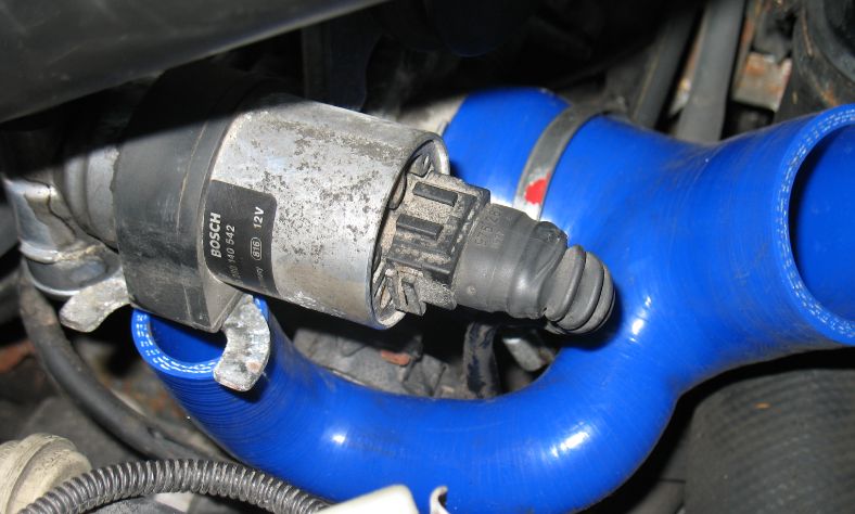

First, should I be worried about the excess material in this hose? This is the hose that has the ‘arm’ running off to the idle control valve:

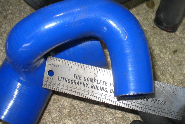

Second; the hose diameters (all of them) seems to be way too small – almost as if the inner diameter needs to be what the outer diameter is. The blue replacement hose that connects to the intercooler has an inner diameter of 58 mm. I didn’t measure the hose that is installed, but there’s no way its inner diameter is that small. The hose clamp has the following marking:
75
58-75
I’m going to guess that is the “usable” mm range of the clamp. There’s not much metal hanging out from under the screw, so that tells me that the hose has an I.D. of 70 mm or so – correct?
