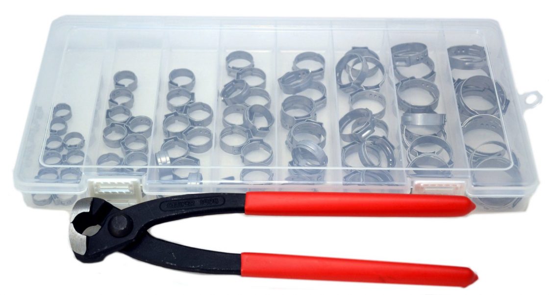

The Oetiker clamps which appear on many Volvo components are likely Oetiker StepLess Ear Clamps in 167 stainless. A complete list of sizes is available in their product catalog, starting on page 35. I’ve come to this conclusion based on the ear and interlock design as shown in the attached picture.

The ear clamp is tightened around the attached hose by specialized pincers, which force the sides in on themselves. The pincers come in a standard style which closes the clamp while being held parallel to the ear and a “side jaw” style which closes from a perpendicular position. The side jaw pincers are used for tight spaces, where it is difficult to reach with standard pincers. It is important to only crimp the oetiker clamps with a single tool stroke. Applying a second layer of force can damage the clamp.
