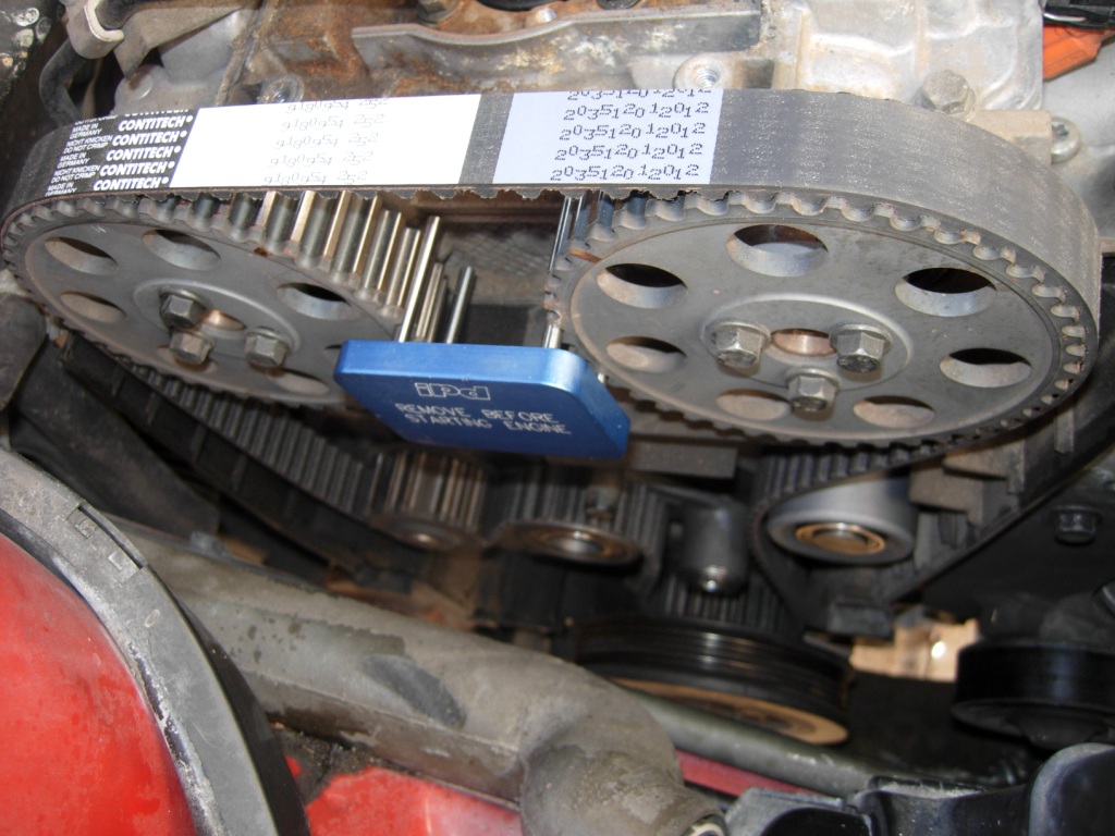

Alright so I have a 2002 S60 N/A with 187k on the clock and am looking to replace my timing belt. It doesn’t look like a hard job and the only things that it looks like I need to watch out for is the timing marks and the tensioner adjustment. Everything else looks pretty straight forward. I am not the original owner but it looks like the t-belt was replaced at the recommended 105k per the Volvo sticker on the ecu.
Now, I’m looking at the contitech timing belt kit that comes with the water pump as well but there seems to be two different part numbers.
There is the TB331LK2 and the TB331LK1. Which one do I need?!
Thanks in advance!
-Billy
