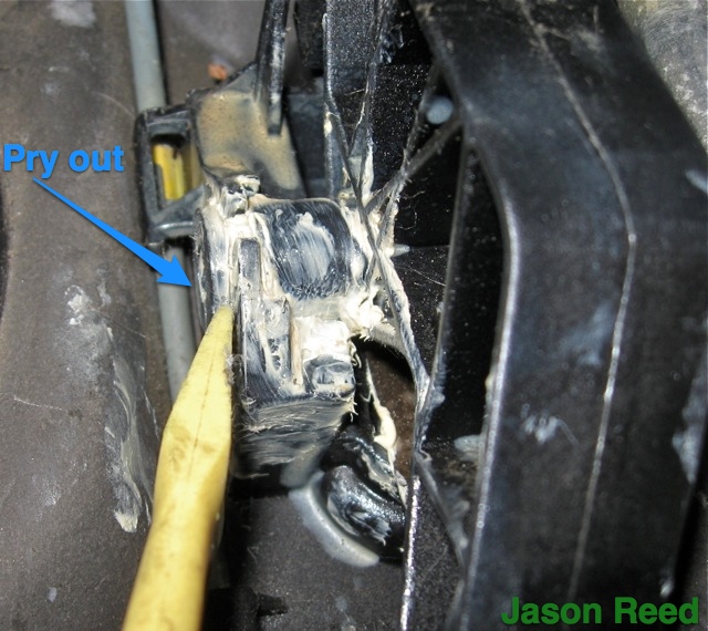

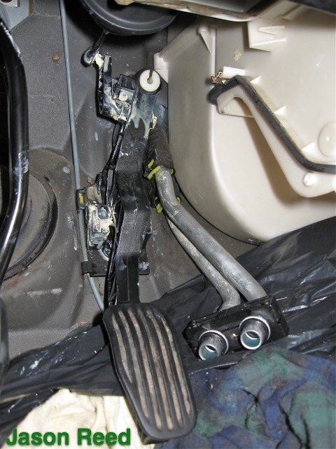

I wanted to add detail on how to get the gas pedal out of the way when removing and installing the metal pipes to the heater core. To me there just wasn’t enough room between the pedal and the white plastic AC duct to allow removal of the coupler:
Heater pipe
Use a pry bar to pry the head on the pedal hinge pin to the left:Heaterpipe2.jpgHeater pipe

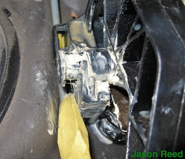

Pry pin out about 1cm:Heaterpipe3.jpgHeater pipe

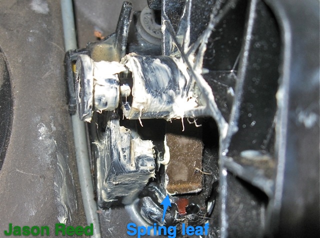

When it is out far enough, the copper leaf spring will push the whole pedal assembly upwards:Heaterpipe4.jpgHeater pipe

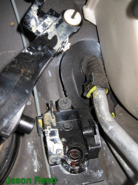

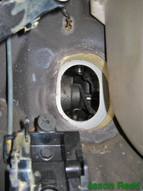

Move the pedal assembly to the side. There should now be enough room to pull the coupler out of the foam ‘socket’ it is pressed into (be sure the two T25 screws in the engine compartment have already been removed):Heaterpipe5.jpg
Heater pipe
After removing coupler from firewall:Heaterpipe6.jpg
Heater pipe
I found that getting the old coupler out was a lot harder than getting the new one to go back in.

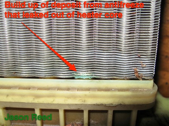

When I was inspecting the old heater core, I found signs of leakage with the biggest being right above the inlet and outlet ports where the aluminum tubes enter into the plastic end caps. There was some green residue visible. I hadn’t noticed any drips, or the smell of coolant, or a filmy residue on the inside of the windshield or detected a significant loss of coolant at the reservoir (maybe 100mL-200mL every couple of months).Leaking core1.jpgLeaking core
The green residue on the core at higher magnification. It looked like some kind of geologic formation you’d see inside of a cave:Leaking core2.jpgJupiter, or Leaking core magnified closeup

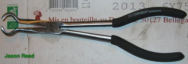

The other suggestion I wanted to make was to recommend a pair of hose pliers for removing the old heater hoses from their connections to the engine. I had a nice pair that I got for Christmas this year that worked really well to grip the hose and let me twist it to break the bond and pull it off the fitting.
Hose pliers.jpgHose pliers
