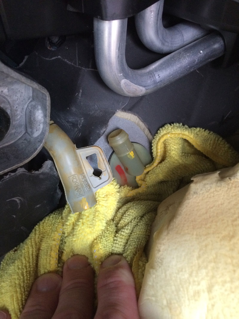

When I ran the A/C the condensation line wasn’t dripping out under the XC. The drain line was plugged. That was the easy fix. Drying out the carper was the hard part.
A/C Condensation Drain Line
  • If you look in the area of the gas pedal to the right of it. You can see a small black flexible hose behind the center console trim pane. That’s the hose you want to pull out and stick a close hanger through to clean out the clog.
  • The trim panel on the side of the console will pull off. Just grab it in a corner and give it a hard pull. Then work it from left to right pulling. It will come off. Just pull it.
  • The black hose is then accessible. Above the hose there is a clear white reservoir that the hose connects to. I could see the condensation (water built up ) sitting in the reservoir. Do the same with the trim panel to the hose. Pull it out of the reservoir. Then pull it out of the floor.
  • Stick the clothes hanger or something small to free up the clog. Put the hose back on. Putting it into the floor isn’t to hard to do. You will have to work the lip back onto its seat.
Just take your time. Take a break if you don’t succeed. Give it another shot. It might be possible to just pull the hose from the reservoir and do the hanger trick. Might work without pulling at the floor?

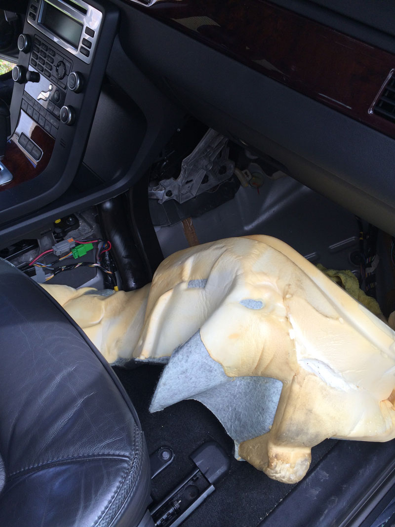

Drying the carpet
It took me about an hour to pull the carpet back and gain access to the soaked foam under the carpet. My drain was clogged most of the summer. The foam insulation was drenched.
  • I took a rope and tied it around the front leading edge of the carpet and the seat back at the head rest to keep it up in the air.
  • I took dozens of towels to soak up the water.
  • A shop vac would be a good investment if you don’t have one.
  • I had 2 fans blowing on the foam insulation for 2 days. Drying with towels the puddles of water.
By the 3rd day it was dried out. It was a lot of work. I can’t image what the dealership would of charged. $1,000 to $1,500?
