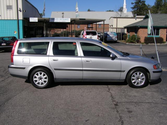

MVS Forums contributor Dirk is looking for the perfect manual transmission V70. Should he worry about the clutch? Slave clutch cylinder?
I’m not familiar with P2 cars, but I want to check out a 2003 V70 this afternoon that looks nice, has a 5-speed and only 64k on it.
I did a quick search but did not see anything specific on common problems. Is there anything other than what I know from my P80‘s that I should watch out for?
