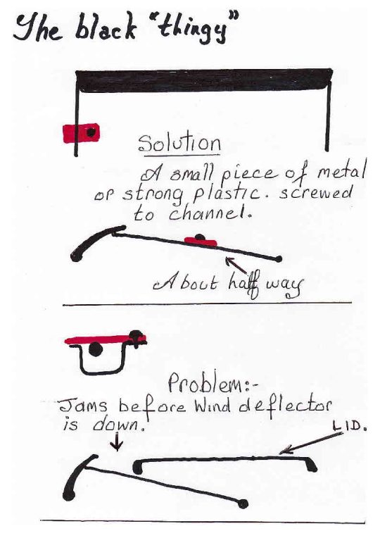

Momsvolvo2 Ā» I have similar problems with my 97 850 GLT sunroof. Slider (sled) in passenger side track broke just in front of the drain channel attachment point. That caused the window to jam open when in the rear position, it would slide forward a couple inches, then reverse and go back. I got it closed by “jogging” the switch.
So I got a track off a 93 850 at the yard, only to discover that on closer inspection it seems to be different form the 97 in some design details, so I’ll need to go back.
wheelsup Ā» Well I swapped the sunroof and the trim panel inside. Went pretty easy. Found out the reason mine pulls slowly backward is because it needs a little grease on the rails it seems. I’ll try adding some and see if that helps. The donor car sunroof had zero rust and looks good. Glad I was able to swap it over, using Lee’s writeup made it painless.
sven Ā» My sunroof got jammed open once in the wintertime. That drain channel broke off and got jammed between the sunroof and the guides. There was no way to close the sunroof. So I was faced with either DIY or go to the dealer. I chose to DIY and basically had to drop and remove the headliner…my 850 is a sedan and I was able to drop it and remove it through the front pass side door. Then I had to unbolt the entire sunroof assembly from the bottom of the roof and replace one of the guides. Junkyard sold me a entire sunroof assembly for $150 which was cheaper than buying just that one guide from Volvo.
